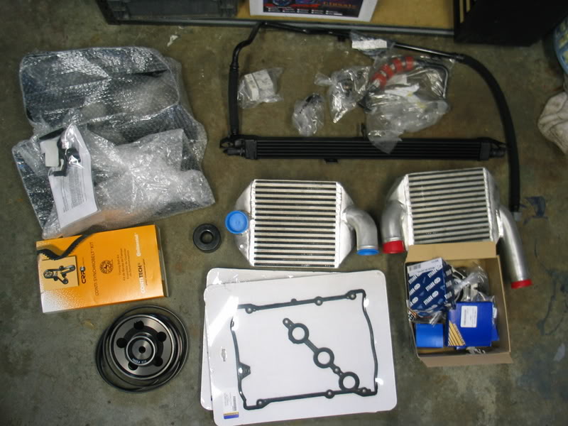

This is what I did on the TB job
Really, the snub mount, & any of the upper cams seals are really about it, you kind of got to replace the acc belt, & of course the WP & thermostat. You can get the LTW pulleys from ECS. Maybe TBB & DV's if you don't already have them done.
