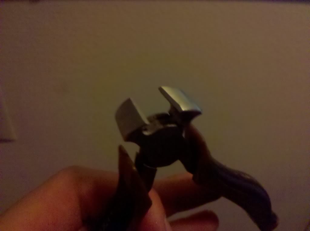

Just finished installing the silicon hose kit I got off ebay (minus the top intercooler hoses cuz I didn't feel like taking the front off again lol but it will happen). Man that F-hose is one pain in the ***, getting those damn factory clamps off was frustrating to say the least but I found a tool that works awesome at breaking those *******. There a type of wiring cutters I forgot the name here's a pic to help anyone else trying to get those freaking clamps off.
I also found a small coolant leak and replaced the 50 dollar hose lol. Basically made sure all my clamps were tight and added some zip ties to the hoses that come off the DV's. Where ever that leak was I'm pretty sure I got it, it's running a whole lot better now. Actually feels like its building boost a whole lot better then time to hold on lol. However there's no place to really open it up like I'd like to where I'm at right now (lots of traffic) but this weekend I'm going to the country roads to visit my parents and can test it completely. I'll post some logs when I'm up there.
