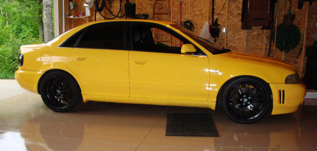

I have 18x8.5's and they just barely fit with the Bilstein struts and H&R Sport Springs. If you're going 19 then pay attention to your compression and spring rates.
You DUB and you RUB.

wow ur car is sick!!!! love the wheels. so ur just running h r sport springs and regular bilstein shocks??? or the shocks that have an adjustable spring cup?? the stance of urs looks like i want mine. just wanting to eliminate this gap in my wheel welds!! ur 18's look big... i want 19's but maybe i should go with 18's cause urs look nice!!

Hah thanks, 18's are perfect in my opinion. I wish the rear was a little lower (would help with the body roll back there as well) but it's as much as I would like for the road. The shocks are non adjustable, it's quite a basic setup.
