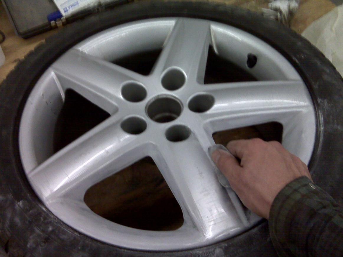

1. Sand stock wheel wherever you want paint to stick. You dont have to remove all the paint but just make it dull and smooth. I used emery cloth. You don't have to go real fine with the paper unless you want a really glossy finish. (I didnt).

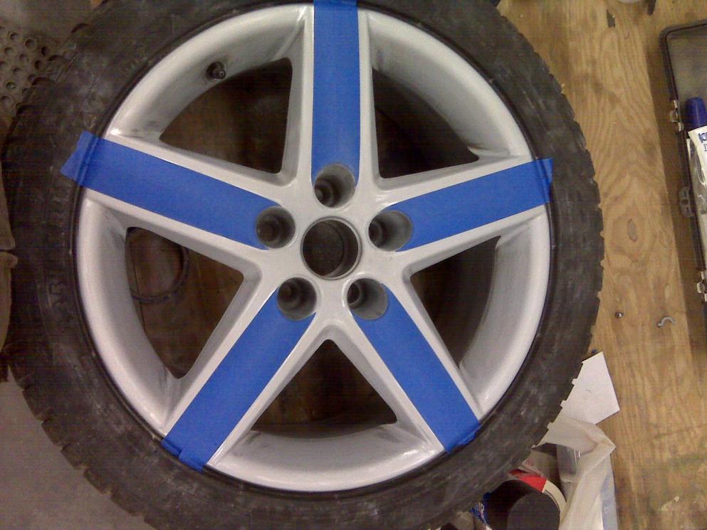

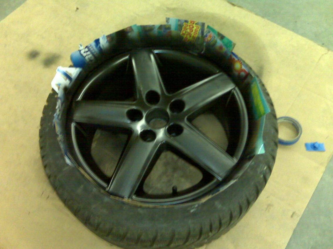

2. Mask all areas you dont want to get paint on. For the tire I used cut up beer cases and stuck them in between the wheel and tire.

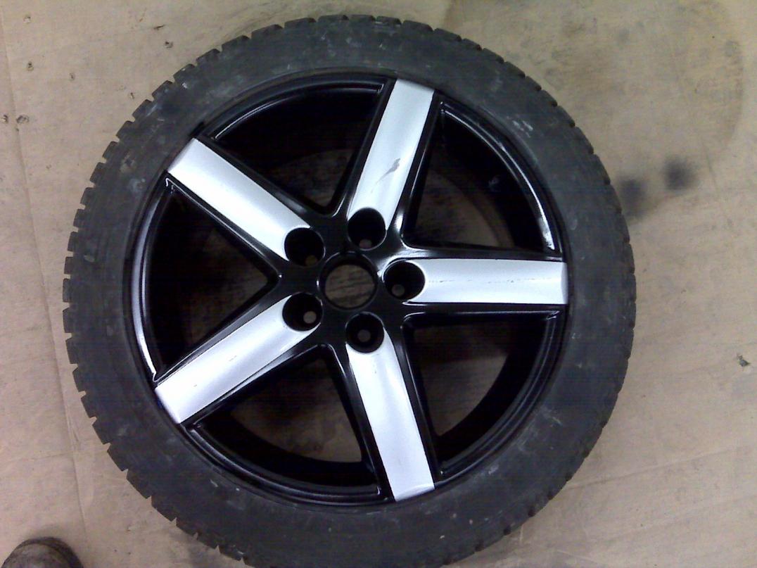

3. Paint the wheels with Duplicolor wheel paint. I applied 3 coats of black paint, then removed the masking (once dry) then applied two coats of clear coat.
Easy as that. Took me about 3-4hrs total.
Sanding all the areas is the most important step as the paint will not stick to the wheel otherwise.
