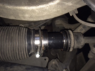

Hi Andy,
Thank you for the reply. It was an air leak from my driver side front wheel. I'm going to attach two pictures. It seems like the top part that holds the air bag disconnected from the bottom piece where the "O" ring is located. I will attach two pictures, one is the broken and the other is the way it was supposed to look. I don't know if it can be fixed.
Also, I started the car to move it bc of street cleaning and then all 4 wheels dropped. I do not know what happened. Any ideas anyone?

is it the lower o-ring around the shock absorber leaking? if only the o-ring causing the problems you could potentially just buy the o-ring from a o-ring supplier,
regards
Andy

It is the lower O-ring that you described. I tried to search for it and could not find any supplier? I already ordered the an air suspension from Arnott. Thank you guys for the info.
