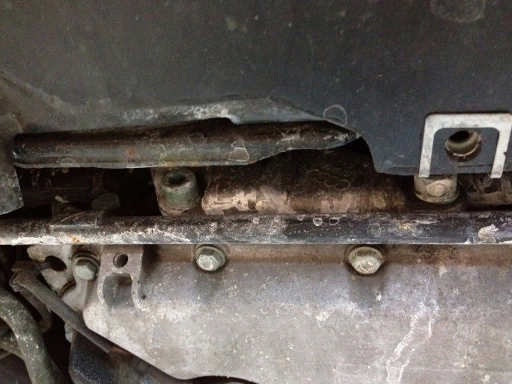

The tech showed me exactly what he saw to determine there was a coolant leak:
Obviously there's something going on. Whether it's the water pump, I'm still not certain. The radiator was replaced about 1 year ago due to a small fender bender so this could be an issue that tracks back to this.
Either way, I'm bringing it to a good independent audi shop tomorrow to sort things out from here on out.
