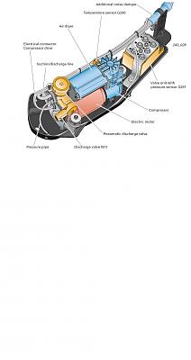

The air spring system control all the time Powered! even when the ignition is switched off. do not do any thing (Disconnect sensors. To lift the vehicle ... ) Until the vehicle is in "JACK MODE". The valves block and the compressor located under the car before the spare tire area. If you suspect thet ther is an air leak Will begin in the rear Air spring just spraying soapy water.

Getting back in the car and starting it will raise the vehicle back to its normal height, this is a result of a leaking air bag, or two leaking air bags. What you need to do is lift the car as high as possible and make yourself a spray bottle with soapy water in it. Spray the solution onto the air bag and look for bubbles. If you spot bubbles you need to get it repaired. Now audi makes a air bag replacement kit for each corner of the car so its easilly fixable. The labor to change them is not so cheap. If you want instructions on how to replace the bags just PM me.
In the case that you let the leaking air bags go on for a long time the compressor will eventually burn out from trying to keep the ride height steady.
Now if you experience a condition that won't raise or lower its most likely a sticking valve block under the rear of the car, its a valve that directs air flow.
EDIT: Another thing that has come to my attention is that the rear air bags almost never leak, i have never replaced one. If you notice that the rear of your allroad is dipping, then spray soapy water on the valve block and lines under the back of the car. Thats most likely the culprit.
