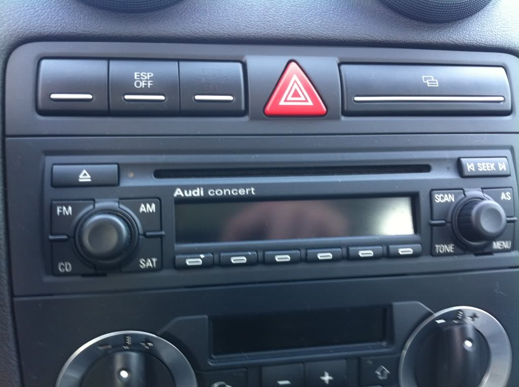

Will these work in an 06 A3 with factory Audi Concert radio without navigation? Thank you for any advice.
iPod Integration
Satellite Module
Here's a pic of my radio.

The satellite module worked great. There are some wires that run along the passenger side kick panel that need to be connected in order for the satellite wiring to be active. But I did not try the iPod integration unit as I don't think the dice system is compatible with iPhone. And I just don't see any point in carrying around an iPod and an iPhone. So, if anyone has any suggestions for Bluetooth or iPhone integration into an 06 A3 I would appreciate the advice. Thank you.

The satellite module is plug and play. There is a home for it in the driver's side wall of your trunk/hatch. But, like I said before, there are some wires (CAN bus) that run along the passenger side kick panel that need to be connected (very simple but frustrating if you don't know about it.) Do not pay the stealership $500 bucks for the module, they are all over the internet for $50 (check eBay and other automotive sites). Good luck. Let me know if you have any more questions. And thanks for the info on the DICE; I will look into it some more.
