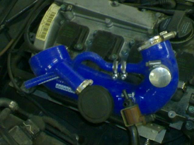

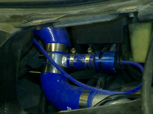

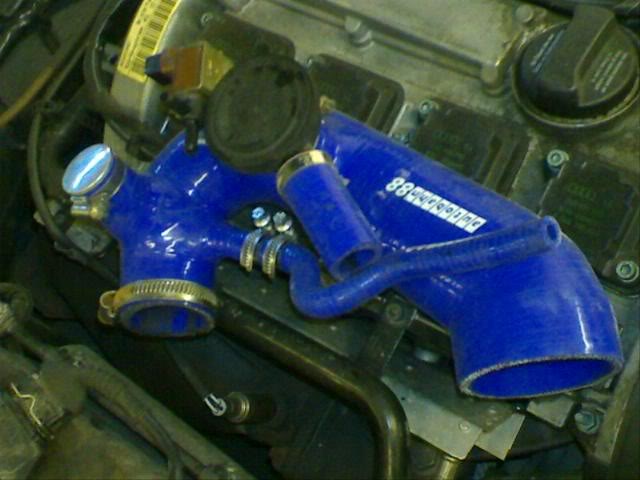

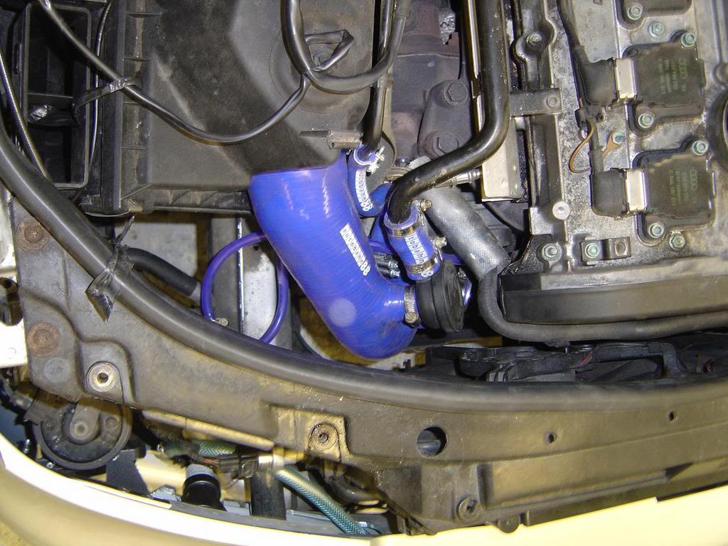

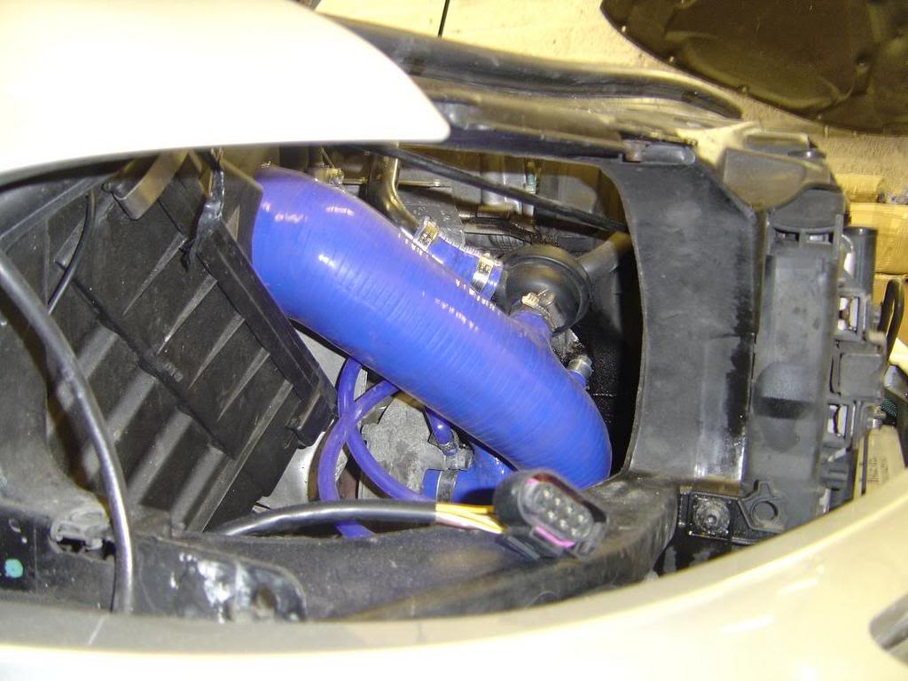

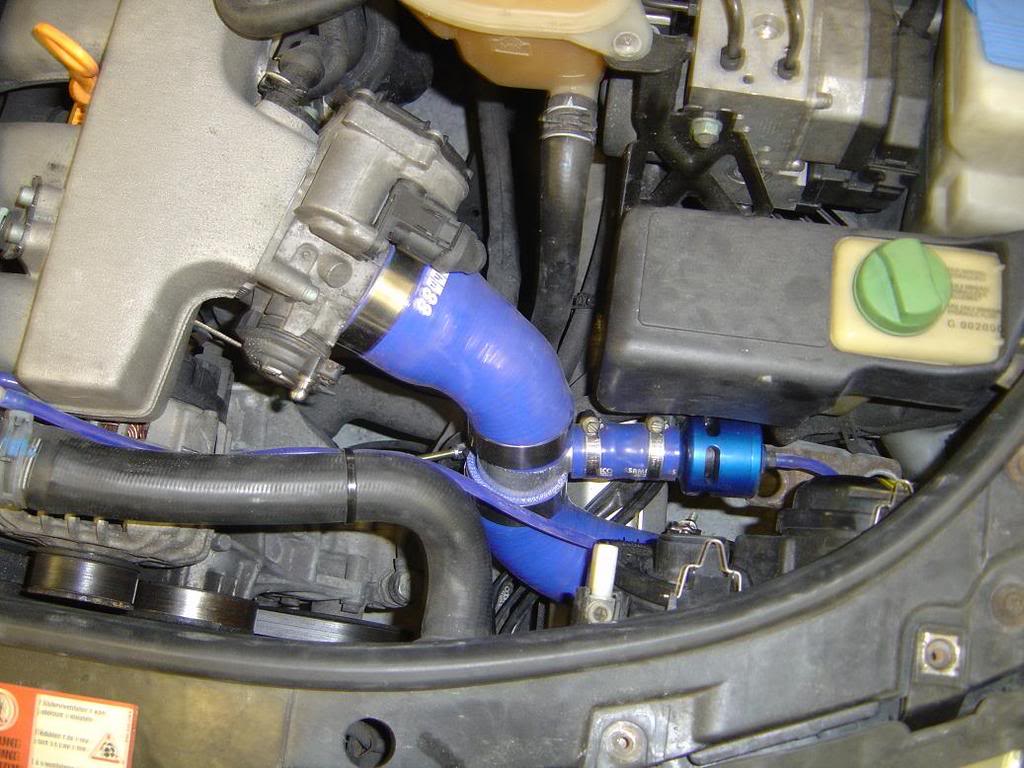

Should have instaled it on the inlet manifold side and dumped or better still just pluged it off out of the loop so it was still there but not doing anything.
I run a Baileys twin piston on the inlet side for nearly two year without any issues but then I do not have the resiviour thing you guys have to have so it made life easy.
Here's some pic's of whats going on under the hood not great pic's but you will get the idea.
