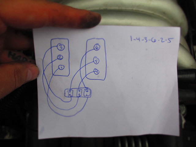

Old Dec 24, 2015 | 09:52 AM
markymarc's Avatar
Joined: Apr 2009
Posts: 675
From: Des Moines, IA
Here you go. Front of car is where the distributor drawing is.
Firing order is: 1-4-3-6-2-5
Attached Thumbnails 97 A4 2.8 fwd. NEED HELP ASAP!!!! Idk what i did to it but its bad.-image.jpeg
