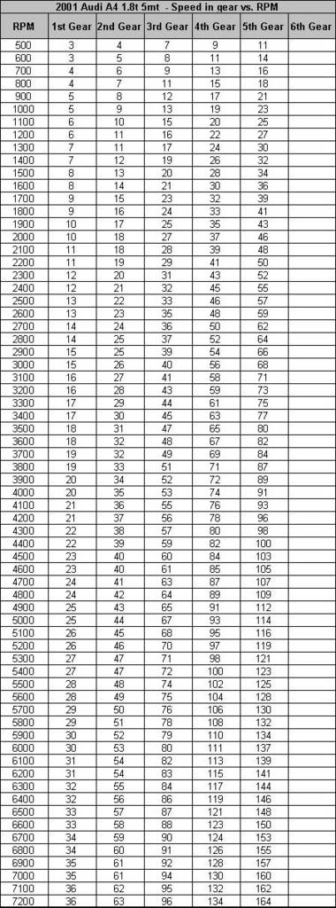

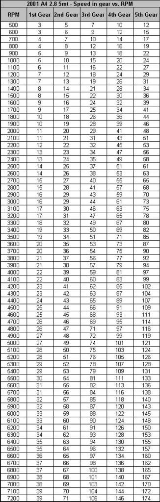

Default RE: Am I the only one thinking that these cars have short gears?
Size:  90.2 KBName:  2001A42.jpg
