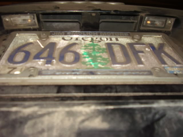

I can pull it down an 1/8". Maybe I need to pull the interior panel off of the hatch?

Got it down 1/4"on the outside and now it won't go up or down...
