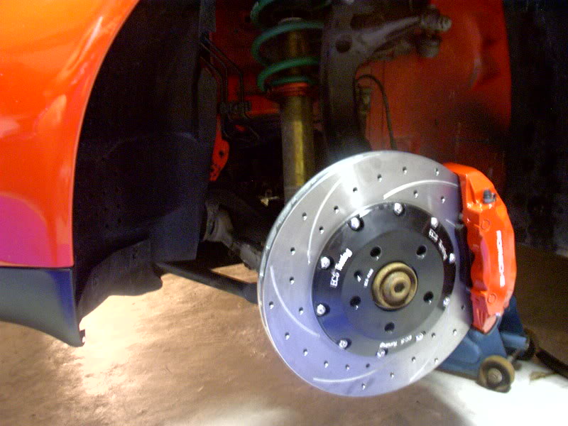

If i was just looking for something better than stock and not going with anything more than 300hp, the tt carriers with the ecs 2 peice rotor would be a great option. You get better stopping power from moving the caliper further away from center (simple physics) and cooler rotors to prevent fading
Yes the rotor hat will disipate the heat quicker, but, vented rotors wit a good vane designalong with cross drilling or slottingwill help greatly in cooling the brakes.
Also brake fade is caused by over heated brake pads, hence the need for track pads, and also underratted brake fluid and rubber lines which can tend to expand.
And moving the rotor further out will not necessarly give you better stopping power b/c simply you are not changing the clamping force of the caliper. Secondly a better pad with a more aggressive compound will aid much more in better braking than just throwing on bigger rotors.

Yes the rotor hat will disipate the heat quicker, but, vented rotors wit a good vane designalong with cross drilling or slottingwill help greatly in cooling the brakes. All stock and replacement rotors will bevented and with agood vane pattern. Cross drilled rotors clean the pad and allow trapped gasses excape in the slots. Crossed drilled allow gas and water to be pushed into the hole for better contact between the pad and rotor. Both of these take away from surface for the pad to make contact with the rotor and dont cool the rotor, just let gas excape. Also not really meant for a mild to moderate street car. The aluminum hat will drop the temps very quickly and prevent fading from happening since it is due to heat (brakes cant turn power in to heat if the rotor/padare already attheir peak heats).
Also brake fade is caused by over heated brake pads, hence the need for track pads, and also underratted brake fluid and rubber lines which can tend to expand. Yes, you need a pad for what your running. They come in differnt heat ranges and running a track pad on the street isnt good nor is running a street pad on the track. There are many performance pad which are a good compermise between the two.
And moving the rotor further out will not necessarly give you better stopping power b/c simply you are not changing the clamping force of the caliper . Someone needs to teach you the law of levers. Simple example, you need to undo a tight bolt, you can either apply massive amount of force on a small socket wrench or get a really long socket wrench and apply far less pressure on the wrench to free the bolt. Same concept applies here. Also your not moving the rotor, your increasing its diameter to move the caliper further out. Same force applied to the rotor, but much greater stopping power. Im sure Papachristou will confirm it for you if you like.
Secondly a better pad with a more aggressive compound will aid much more in better braking than just throwing on bigger rotors. well duh, thats just common sense.
