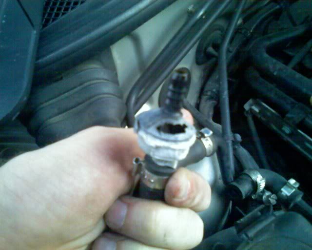

As i was replacing the MAF, i noticed the in-line check valve was busted..
see image:

So I took the car for a drive, and now as soon as the turbo starts to spool, it seems to "pulse" in and out of boost, enough to feel like a bad bad misfire.
I drove around the block a few times very light-footed and haven't pulled a new CEL.
Should I assume that now that the car is out of "limp mode", that the extra boost is being messed up by this valve?
Or should i look elsewhere to resolve this problem?

Haha.. Same EXACT thing happend to my check valve at the same location. I didnt have any noticeable running issues when my valve was rotted out like that. I happend to find it during a boost leak test, fixed it, and didnt notice any improvements afterwards. If you just replaced your maf, give it some time. When I replaced my maf, it seemed like it took it a day or 2 for boostlevels to be moreconsistant. What are/were your fault codes?

You should be ok, just replace that check valve first and see what happens. If you have a problem after replacing that known bad part then we will diagnose whats going on.

The check valve it to the EVAP system and will cause a large vacuum leak. It rubs against the metal clip back there. Not uncommon problem on the A4.
