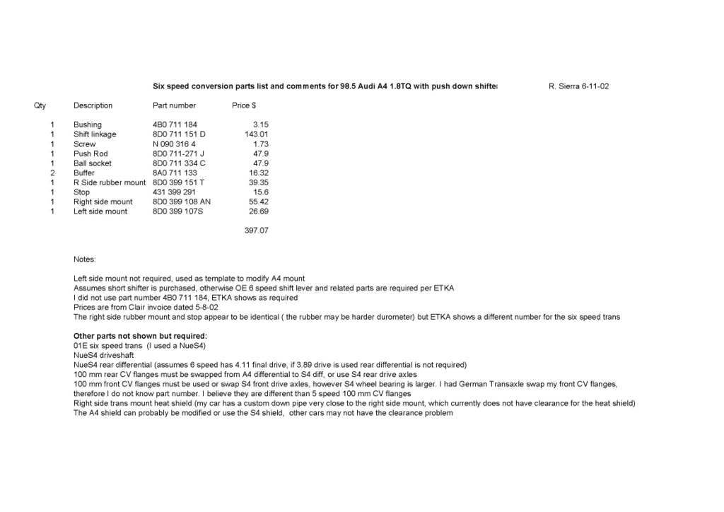

and in case you were curious as to what it would cost to swap in a 6 speed tranny
