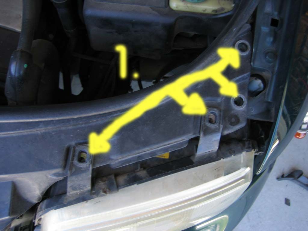

1. I removed the top four torx screws.
http://i41.photobucket.com/albums/e2...headlight1.jpg

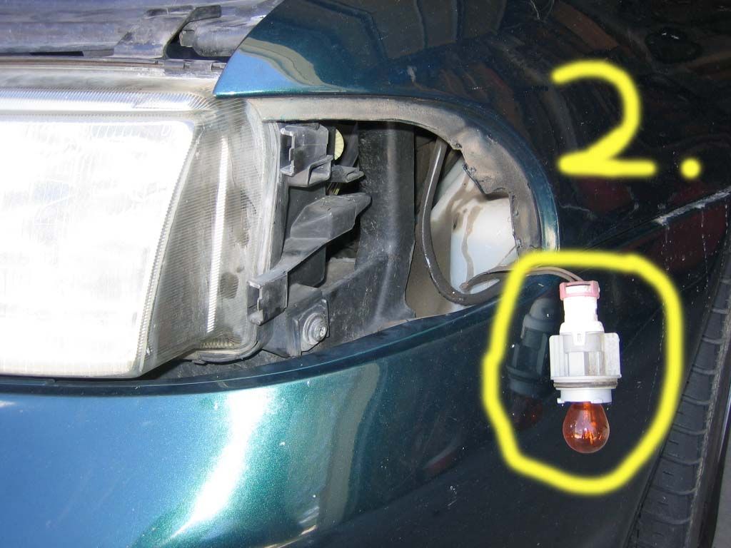

2. I removed the turn signal assembly fine and then tried the remove the front headlight but it wouldn't even move.
http://i41.photobucket.com/albums/e2...headlight2.jpg

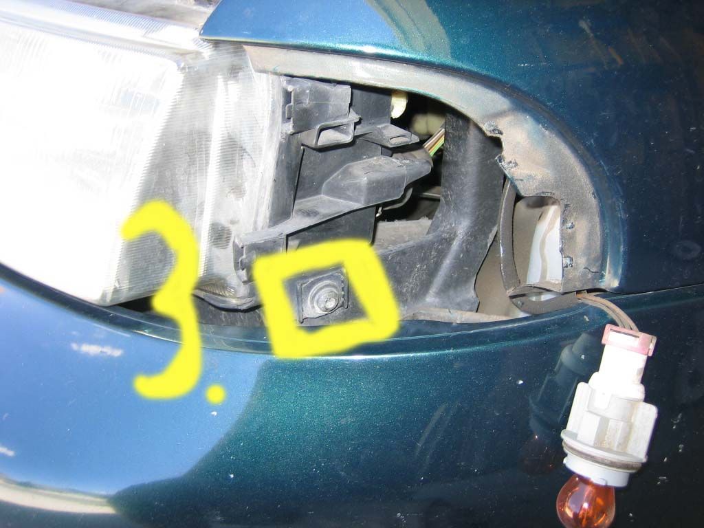

3. Then I found this screw and thought that this might loosen the headlight up so i could slide it out. But my problem was that the bumber was in the way for my screwdriver to fit in there. What should i do. Do i even need to remove this screw or does it stay. Anything is helpful, thanks everybody.
http://i41.photobucket.com/albums/e2...headlight3.jpg
thanks!!!

The screwdriver isn't gonna sit flush but the angle should be good enough to remove it. They are designed the same on all b5s I don't see why yours would be any different. You could also try using a 1/4 torx socket with a ratchet or even with a swivelhead extension. If all else fails take off the bumper, I don't see that happening though. Good luck.

im sure there is a bolt to the lower left of the head light glass you have to push the bumper down to get at it, #3 picture the bolt needs to come out
