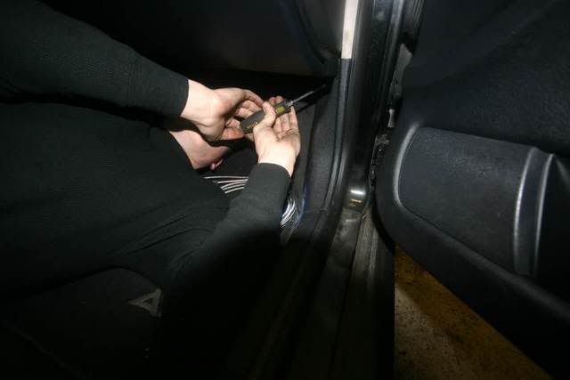

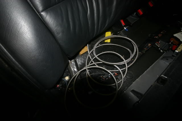

so today i final decided to put in the nitrous, i took pics as i went, so here they are. Its all strung up and together, i just need to run a few more electrical components tmrw and get the bottle filled. we tapped into he intake manifold between the throttle body and the maf, its all very hidden and almost completely unnoticeable except for a few extra braided lines peaking out.

under the back seat and along the passenger side plastic

Think you really should of ran the lineunder the car and not through it. But cant wait to see it run. SHould be a blast.

well its inside the plastic molding, took it all off and ran it through it. oh, and i got the service manual, fuel pump pressure its 46-54psi connected, if i rember correctly.
