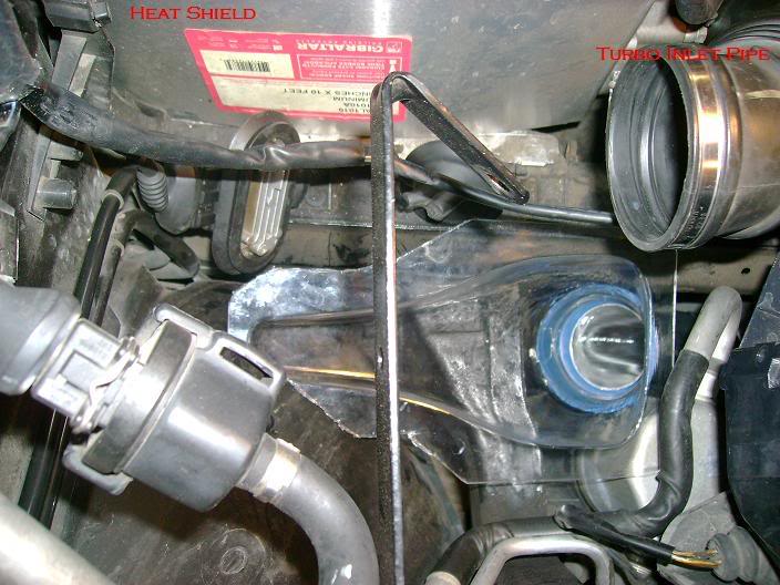

so, I have a custom intake setup and all summer I was fine w the fact that the bottom of the intake was succeptable to the elements (without box and bellypan you can see da ground. well, because of recent rain i decided that I had to cover up the hole so that water wouldn't bounce onto the filter....
after putting the alluminum plate in that blocked everything from underneath the filter I completely lost the sound of the turbo spooling and my 710n was extremely quiet....(which I didn't like, because I love the blow-off noise and the turbo spool)

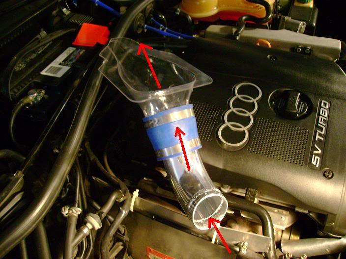

so, this is what I did;
I used a drake cooling duct/a piece of silicone tubing and I chopped part of a leftover intake (from my miata)
I fastened it down by drilling a fer holes around the edges and zip-tied them in place

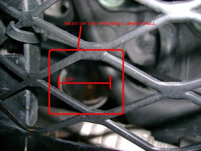

this is a pretty crappy pic of what the piping looks like installed behind my lower grill
Well, I am happy to say that I am no longer worried about water hitting my cone, and at the same time my blow off and spool are 100x (no joke) more audible than they were!
