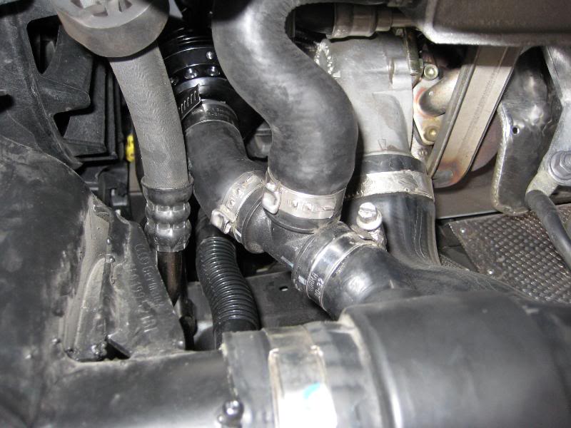

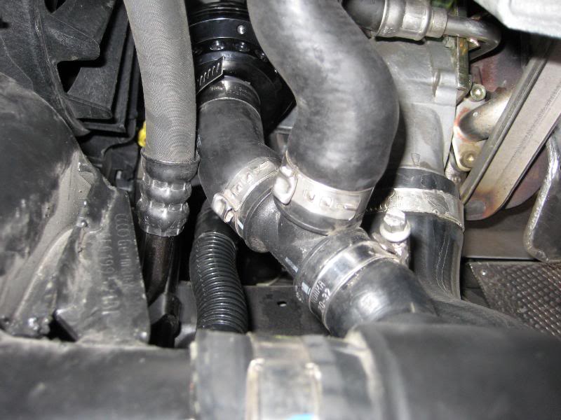

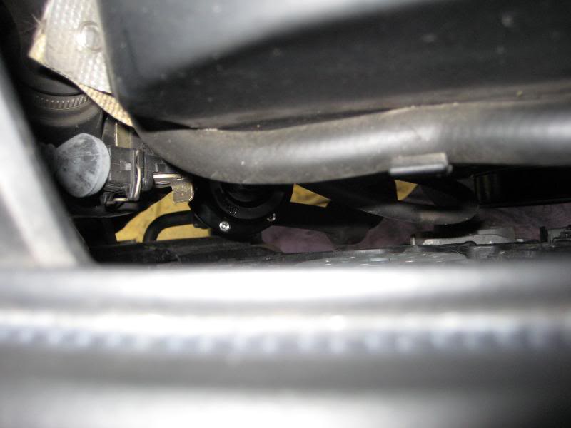

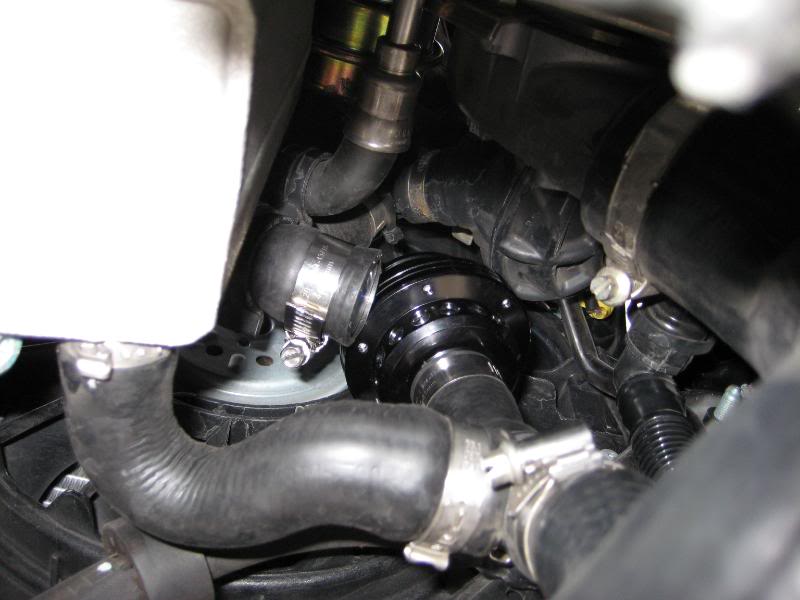

Hey guys I just installed my forge004 valve in my B6 1.8T. Heres some pictures. I just want to know if I did it right, before I attempt to start the car. Thanks

looks about right. i did the same 004 in my b6. fire it up. if you get no whoosh when letting off. it wont hurt anything you juts know you did it wrong

So I plugged the TIP hose right?
Old Dec 20, 2007 | 11:49 AM
auditurbo381's Avatar
Joined: Apr 2007
Posts: 419
From: San Luis Obispo CA
Default RE: URGENT! please look at this... Install help!
yah the top vac line is what i screwed up. you better of fired it up by now. your car would idle like **** if your vac peice was messed up. and if it was on backwards it wouldn;t work. as long as it works there should be no issues.
