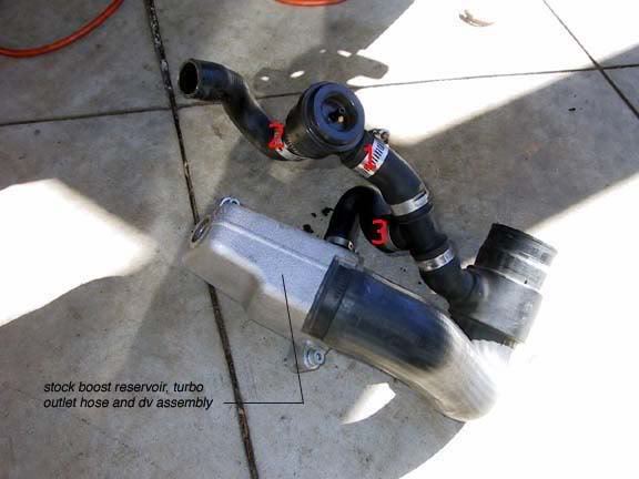

The res is the resevior shown above. I say install the bov where the Tee peice is and leave the plug where it is. That res(evior) is messing things up. Cut it out of the system since it is redundent and removing it off the car is better. Then try that out. If it works better, then undo the battery for 10mins and go from there
Im sorry please have mercy on me. I should plug #1 and hook the BOV into #2. Right now the BOV is plugged into #1 and #2 is plugged off.

What I have gathered so far.. what cincy says I should do would be plug the BOV into hose #4 eliminating the res and leaving the plug in hose #2
but like I said in the last post I have been told by chaos (he has a forge 004) to plug the BOV into hose #2 and plug hose #1
oh please continue to help me cincy

This way
[IMG]local://upfiles/28034/F1D677E4229C4F75B623E89AF06C76EF.jpg[/IMG]

The reason Chaos's setup with the 004 looks different is that he has a B5, and your car is newer andhasa different setupwith the res. Don't worry about the physical "position" of his 004 to yours. Just think of it in terms of where the boost pressure isbeing released from - thepipebetween the turbo andintercooler, andthe vaccum line goesto the top of the BOV.

ORIGINAL: Bogie
The reason Chaos's setup with the 004 looks different is that he has a B5, and your car is newer and has a different setup with the res. Don't worry about the physical "position" of his 004 to yours. Just think of it in terms of where the boost pressure is being released from - the pipe between the turbo and intercooler, and the vaccum line goes to the top of the BOV.
So thats why the car is running and the valve is releasing the pressure like it should, but the res is messing it all up.
I want to do what Cincy is telling me to do then correct? Im suppose to eliminate the res? I have to take the car in tom morning at 8am too to have the license plate lights fixed... they will kill me! Im gonna have to move that back
Im so worried about fecking something up []

i would remove the res personally. Like said before, its redundant. Why would they kill you?
