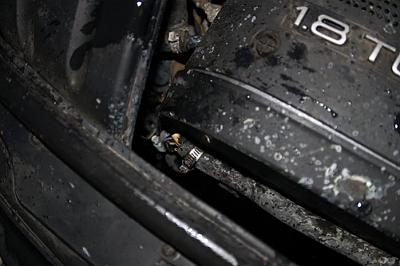

About a mile from home my dash flashed a low coolant warning. After slowing down I could see white smoke coming from the engine, front right passenger side. I tried tracking down a parts diagram on google images without any luck, does anyone know this tube part number. Second question, do you think 1 mile of driving without coolant ruined anything? Thanks again for your input, I appreciate your help.
Attached is an image of the hose break.
Attached Thumbnails White smoke front passenger side, snapped coolant hose leaking smoke, pics-audi-1.jpg

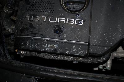

Default pic 2
pic 2
Attached Thumbnails White smoke front passenger side, snapped coolant hose leaking smoke, pics-audi-2.jpg

Default Part number 058 121 471 b
If anyone else comes across this thread, the part number I purchased is 058 121 471 b and a good diagram is ETKA illustration 121-48, 04 a4 b6.
