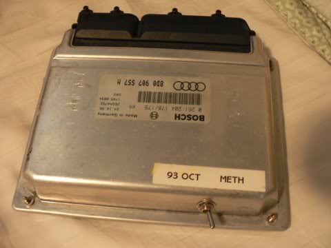

There are some good write ups on Vortex about it and a wika page that was very imformative aswell, but i cant seem to find that page again [:@]
But to my understanding is that Lemmi/Unisettings doest work on pre2k cars. So you need to have a race file or water meth program installed in the ecu like so

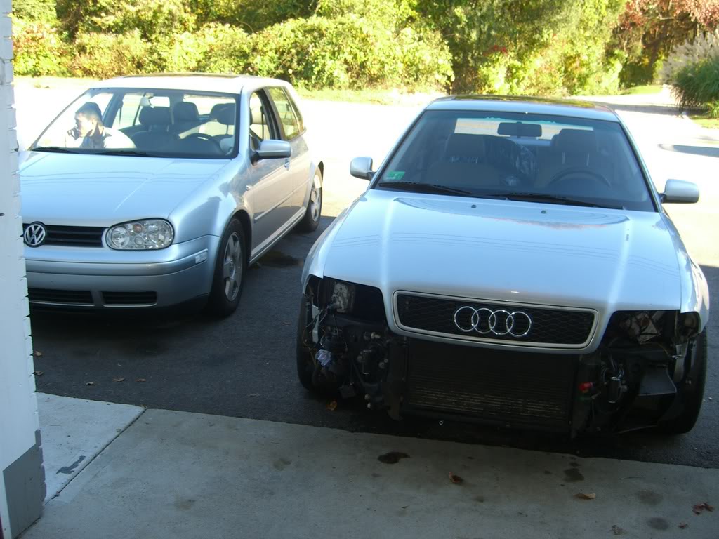

In the B5'er
