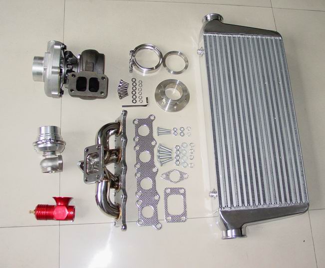

MANIFOLD - STAINLESS 1.8L T3/T4 also got440cc / 44lb fuel injectors / bosch green tops and i got a test pipe
so maybe some software i know gaic wont work with this turbo and a fuelmanagment system
T3/T4 FLANGE .70 HOT SUPER SPOOL
38mm WG BRAND NEW
RFL BLOW OFF VALVE - BRAND NEW
GASKETS
FLANGE FOR BOV
FLANGE KIT FOR WASTEGATE
TURBO ACCESSORIES !!
INTERCOOLER
MANIFOLD INFO:
This manifold is drag-race quality, and similarly design manifolds can be found on professional drag cars.
Manifold has flange for an external wastegate. And since this manifold is tubular steel, it flows better than cheap cast iron
and is less prone to cracking. It was custom-made to be used with A 2 BOLT external wastegate.
TURBO INFO:
T3 TURBO INFO AUDI T4OE TURBO
3" INLET DIAMETER
3 V-BAND" OUTLET
WET FLOATING BEARINGS
1/8 NPT OIL INLET
.50 A/R .70 HOT
57 TRIM
SPECS:
STAGE IV WHEEL
BALANCED AND BLUEPRINTED AND COMPRESSION TESTED

wow...intense. do you want to go standalone tuning or predone?

tell me thats not an ebay kit

ORIGINAL: chaos92287
def looks like an eBay kit....
take a look at unitronics....
gl!

^yeah thats what i thought. but yeah unitronics, mika, revo. they all make BT tuning. i wonder if thats one of the super glued models? already know its gona have quite the bit of lag since its a floating bearing. shoulda just bought a gtrs elim
