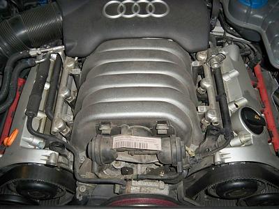

Hello,

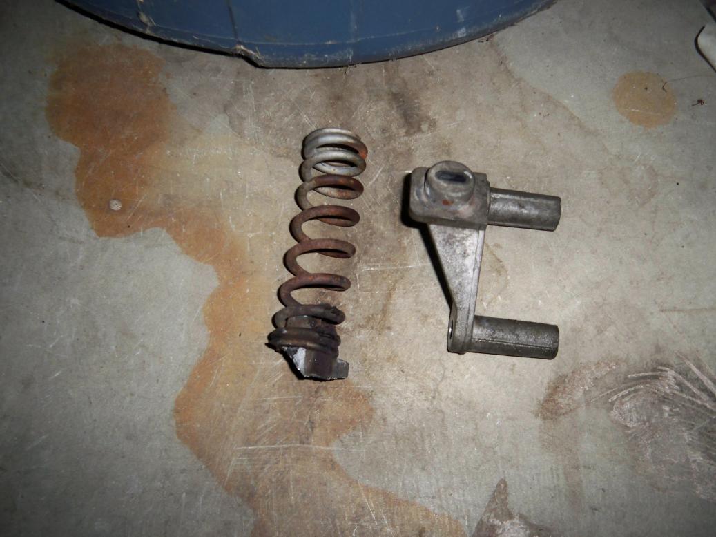

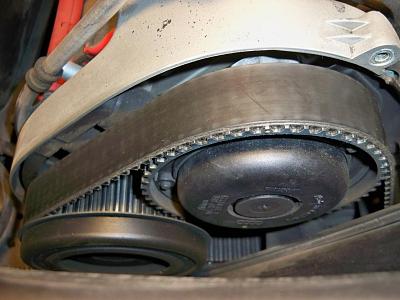

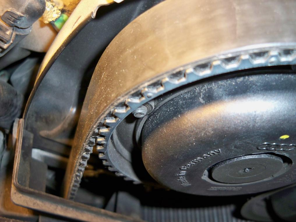

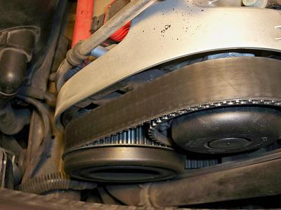

I had a broken serpentine belt tensioner last week. Its spring's end got stuck between pulleys and started to wear the serpentine belt. I bought the tensioner and serpentine belt. I thought I might better replace timing belt as well. I just don't know if the previous owner had it replaced before. I have tried to find out but I have not been successful on that. The car has 90k miles. I guess a broken tensioner is a sign that timing belt service might not have been performed yet.
I just wanted to ask you guys if you could have any guess by looking at the pictures of the timing belt. Any quick comment would be appreciated. Thanks in advance !

On the timing cover bolts you should have seen or noticed paint on them. If you saw paint, then chances are the service had not been done yet. If you did not see paint, then chances are the service was done.
Those pictures really don't do justice to determining the exact condition of the belt.

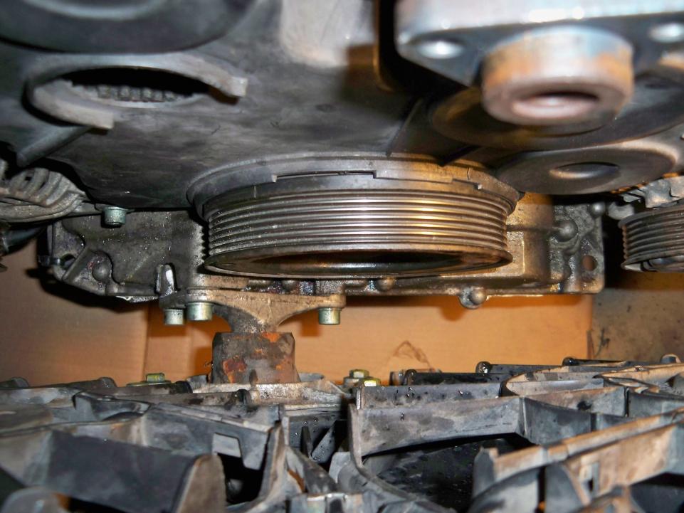

For people trying to just replace the tensioner, you need to remove the bumper cover and pull the radiator block a little bit forward to do the work. I did my best to do the work without removing the from bumper; however, I was not able to put the tensioner in that limited space. So, to save time start by removing the front bumper cover. Fyi, I removed the stering pump pulley.

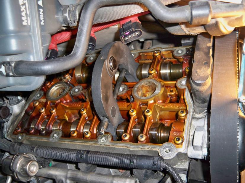

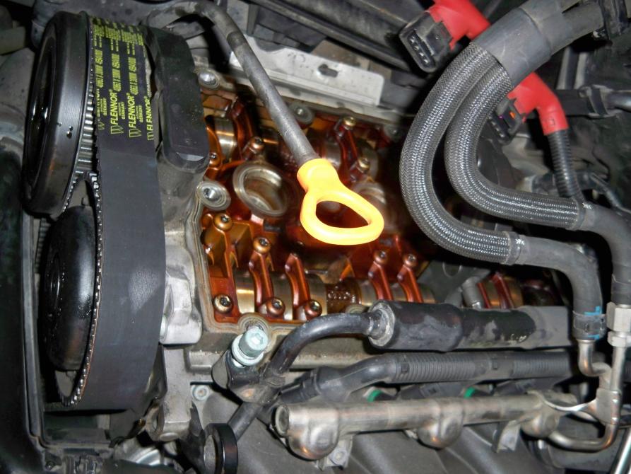

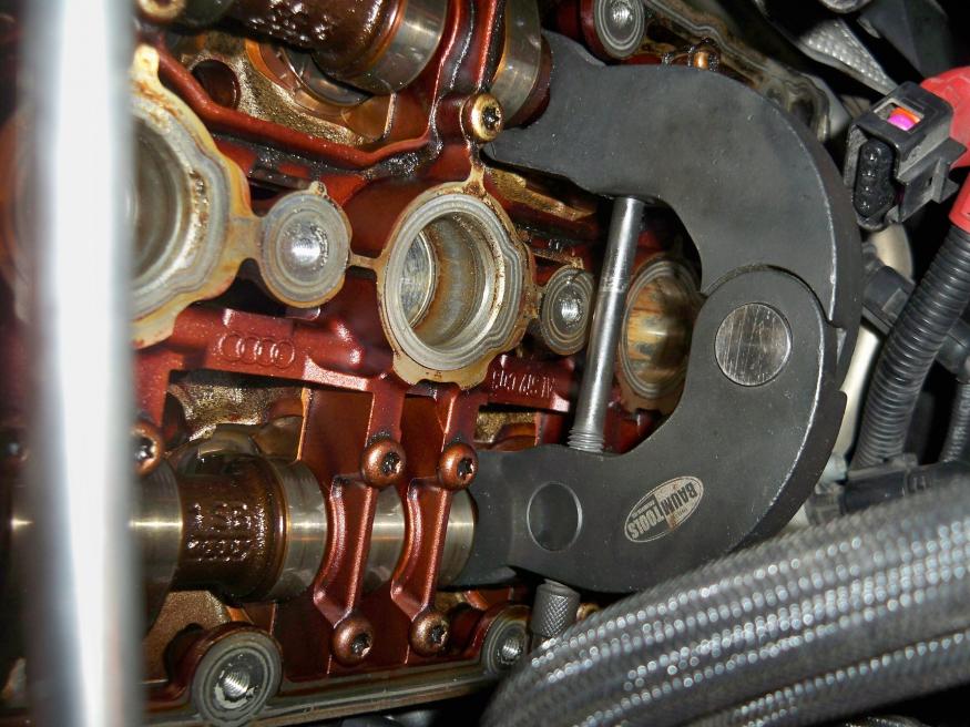

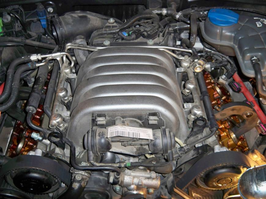

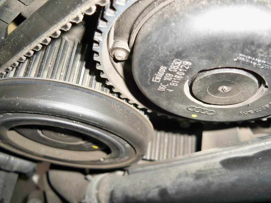

I was following the instructions on AudiWorld Tech Articles. I have almost completed. I still have camshaft lockers on. However, after being done with replacing timing belt, water pump, timing belt tensioner, thermostat, idler pulley eccentric pulley, and timing belt tensioner pulley, and putting the rear cover, I realized that crank pulley is not alinged with the TDC line anymore. I have attached the pictures. I guess I need to loosen the camshaft pulleys and rotate crank without rotating the camshafts (where lockers are still engaged). I bought the enhanced timing belt kit from Blauparts. I have some issues with it but no need to talk about it. I also have the tool kit from them.
I wonder if anyone had the same problem before. Do you suggest anything ?
