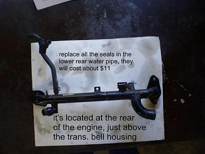

Your leak probably looks like this. It's a common problem. The lower rear pipe is located behind the engine. Buy the seals from Audi, as a few of the seals are high silicone content to handle the heat from the engine block.
Sorry, the photos didn't load

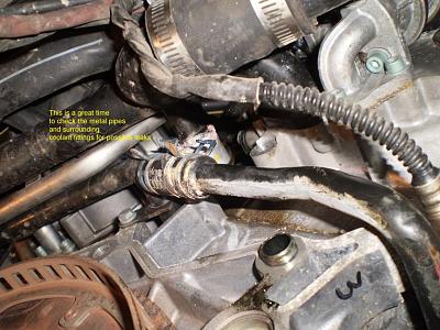

Default leakage
Here's some photos
Attached Thumbnails 2002 4.2 coolant leak...can't find source...pics-p5150131.jpg   2002 4.2 coolant leak...can't find source...pics-p6120062.jpg
