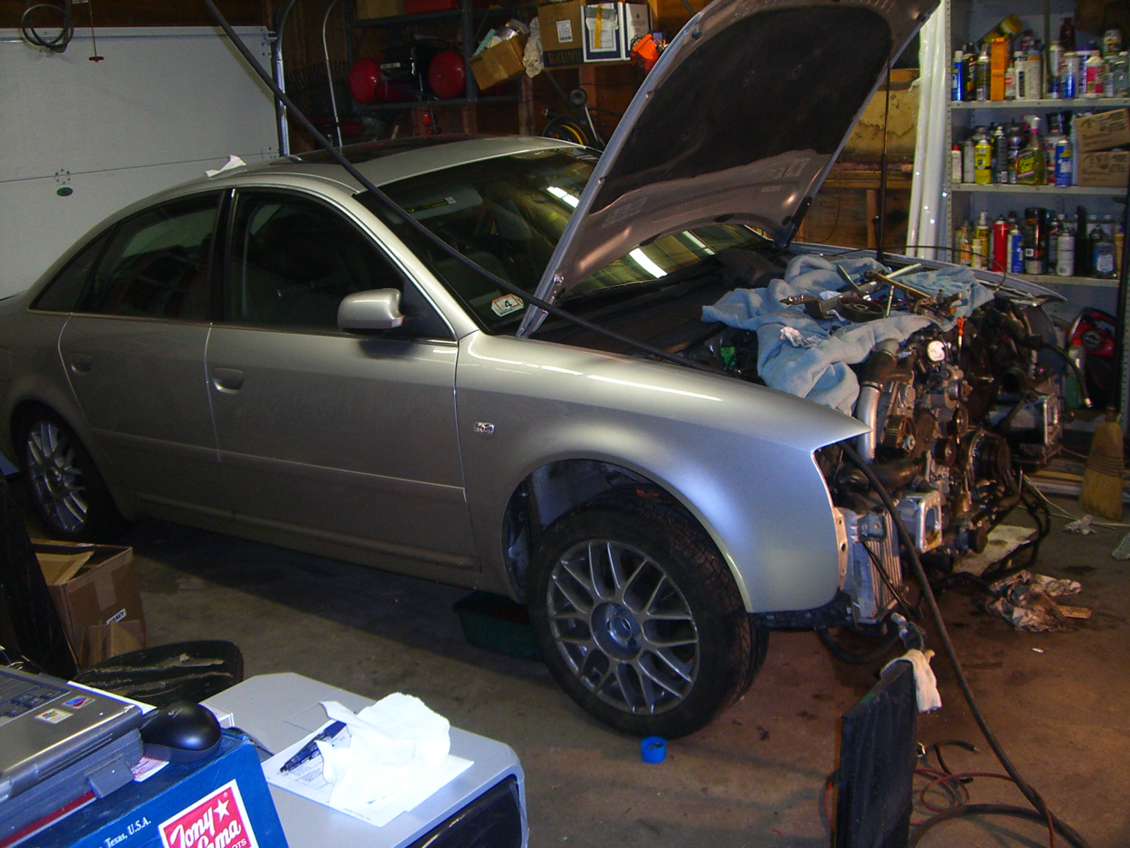

I removed my carrier when I did the tbelt and cam adjuster gaskets in my 02 2.7. It may take a little more time, but it is awesome if you have a bad back. You can basically sit in a chair and do the work. Plus it gave me nice access to de-grease everything from the darn camshaft adjuster seal leakage.
http://jlag.com/2.7tLabotamy.jpg
BTW, you dont need to remove the engine mount to get access for the crank shaft locking tool, just takes tenacity and a bunch of tools the first time.
