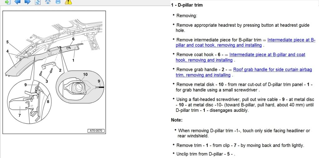

Before you do that try blowing some air through the tube located in the passenger door frame near the hinges.
If you have been there done that I would suggest you get a copy of the manual. www.bentleypublishers.com (an absolute must if you own this car and plan to keep it) You need to disconnect the battery, remove the center, side and upper pillar trim, (where the air bags are located) It is not hard there are only a few screws and then they clip in but you really need to see the pictures, torx drivers, patients and a few hours of time. If you can't afford the manual right now let me know I'll try to post some of the pictures there's about 40 of them though.

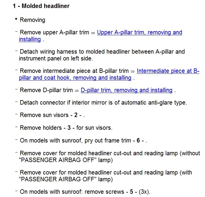

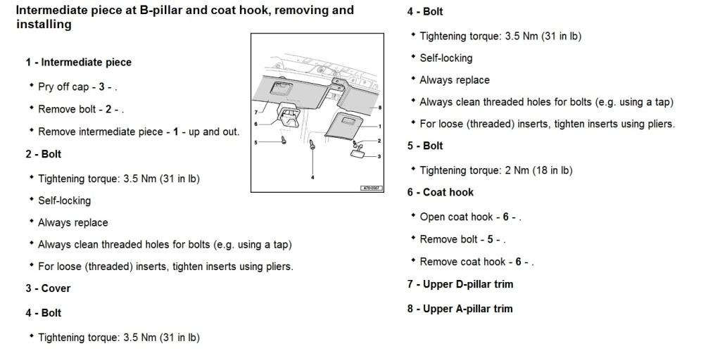

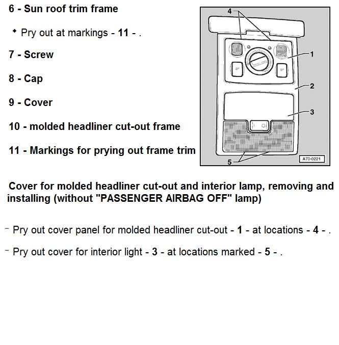

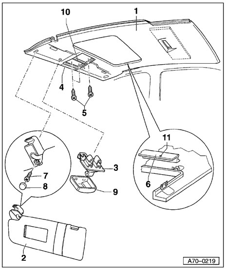

Old Oct 16, 2009 | 07:03 PM
Jackmup's Avatar
Joined: Mar 2009
Posts: 1,227
From: New York

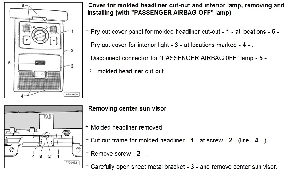

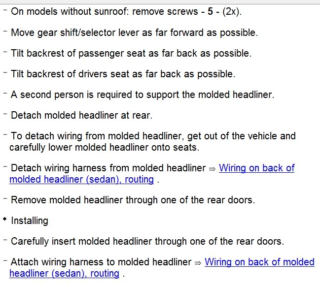

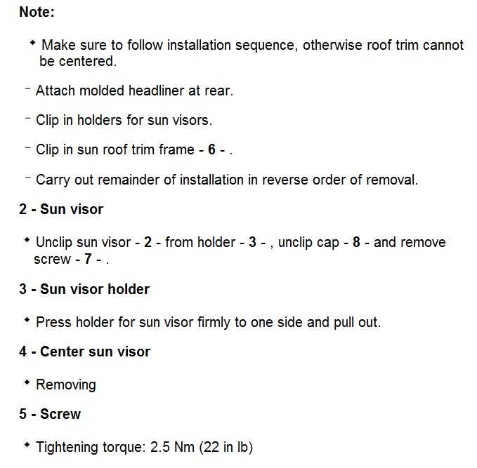

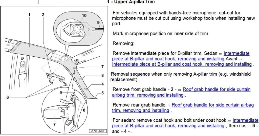

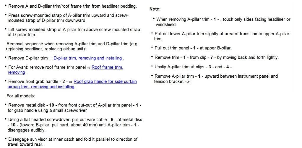

Let me know if you need anything else, The handles are basic pull them down from the upper pillar and pop the screw cap open with a thin screw driver or pick. All of the other stuff seemed basic too.
