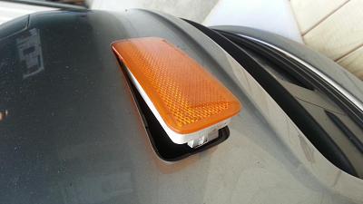

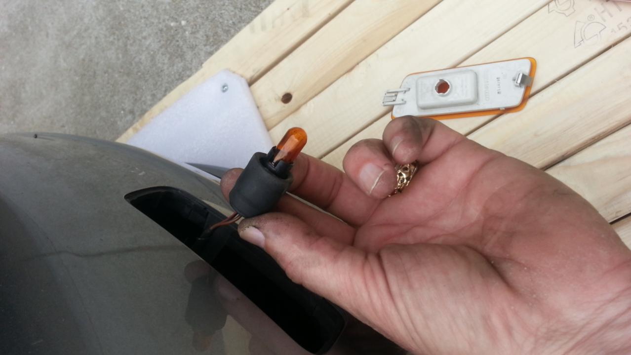

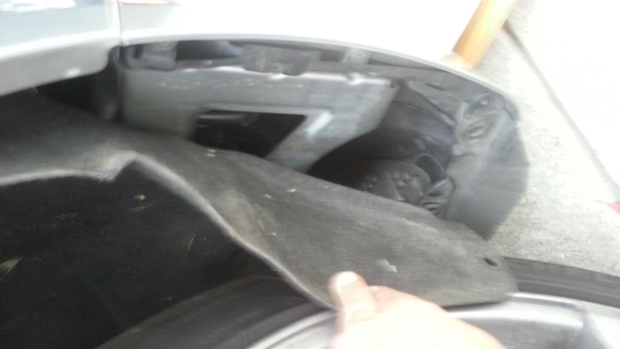

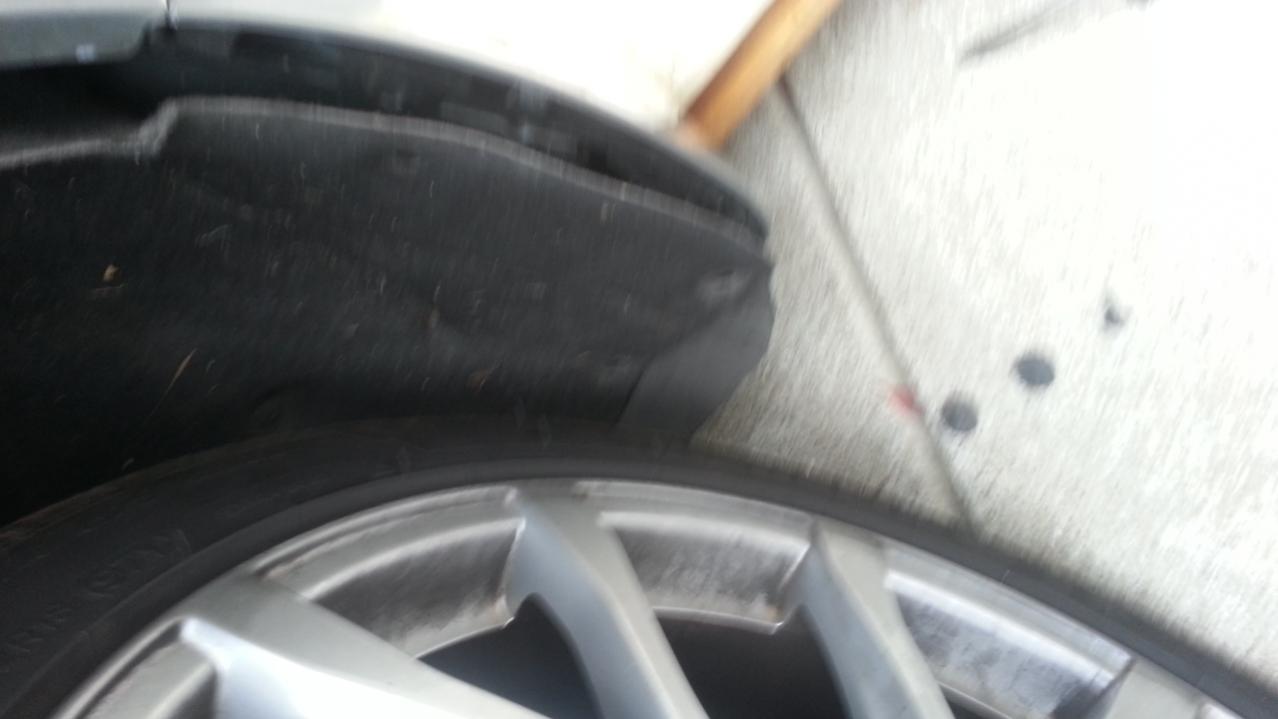

I elected to remove 3 wheel well screws holding the weather cover to the body. I was then able to reach up into the bumper, find the rear of the light fixture, press firmly and it pops out. Bulb held in with a rubber fitting, apply a bit of leverage from a small flat screwdriver, and then the light is easily removed/reinserted. Reverse procedure to button it up. About 5 minutes in all.

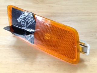

I had the same question, but worked it out without any scratches or dismantling. I used some good duct tape (REAL duct tape used for actual HVAC work, although standard grey tape might work also) securely stuck to the back of the assembly. Just a very easy pull to the rear end of the lamp assembly and it popped out. Swapped bulbs and was done in less than a minute.
