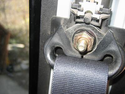

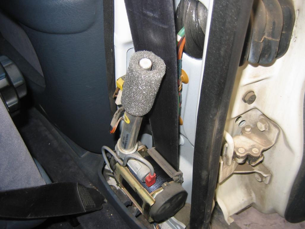

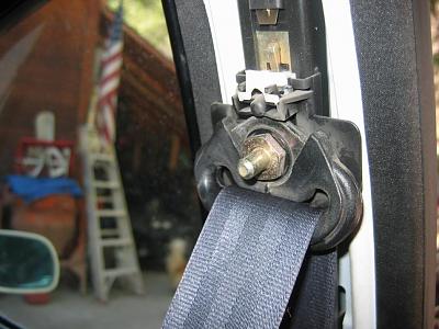

In any case, I may have written here on this thread the continuing and worsening problem with the front seatbelt retractors operating very sluggishly, often resulting in my slamming the door on them. Yesterday, I got into the passenger side to investigate, not-so-successfully pulling off the plastic bottom sill plate (Shokan, here I come again!), breaking the plastic but eventually exposing the retractor system. What preliminarily appears to be the case is that the actual retractor down by the floor seems to work quite propery WHEN I create slack in the belt between said retractor assembly and the upper, B-Pillar mount/loop. Therefore, my suspicion is that, because of aging (perhaps the thickening and hardening of the belts themselves- just like me!), the belt no longer passes smoothy through that upper loop. This I further confirmed when I detached that upper loop and manually angled it in such a way that allowed the belt to extend and retract smoothy and smartly. So, what to do? Replacing belts is costly because of the liabilities involved, I think, so I'm going to try to either create an angling shim to all the belt to travel more smoothly through its cycle and/or open up the slot in that belt-loop mounting. Stand by and check out the attached pics for your viewing pleasure! Any thoughts from my "homies" out there would be greatly welcome, as always!

Think I'll do both of my planned interventions and rewind/tighten up that spring, hopefully without busting it, and then also open up that belt loop a bit without harming the belt itself. Stand by and thanks, as always, for your input!

Man, I wrestled with tightening the coil return spring last night. IF that sucker pops out of it container, It'll launch out like a bomb and it's a real two-handed wrestle to rewind the thing. So, be careful out there IF you try to do this. I'm going to reinstall the tensioner today and see if it's better. It appears to be so. . .Stand by! Couldn't snap any pictures 'cause I was grappling with the spring!
