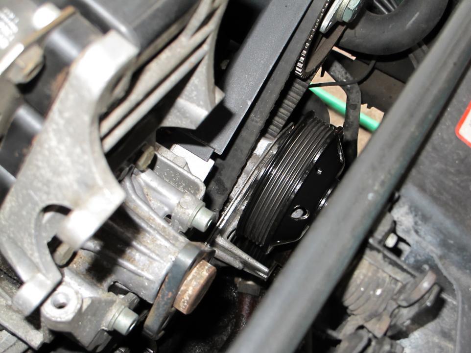

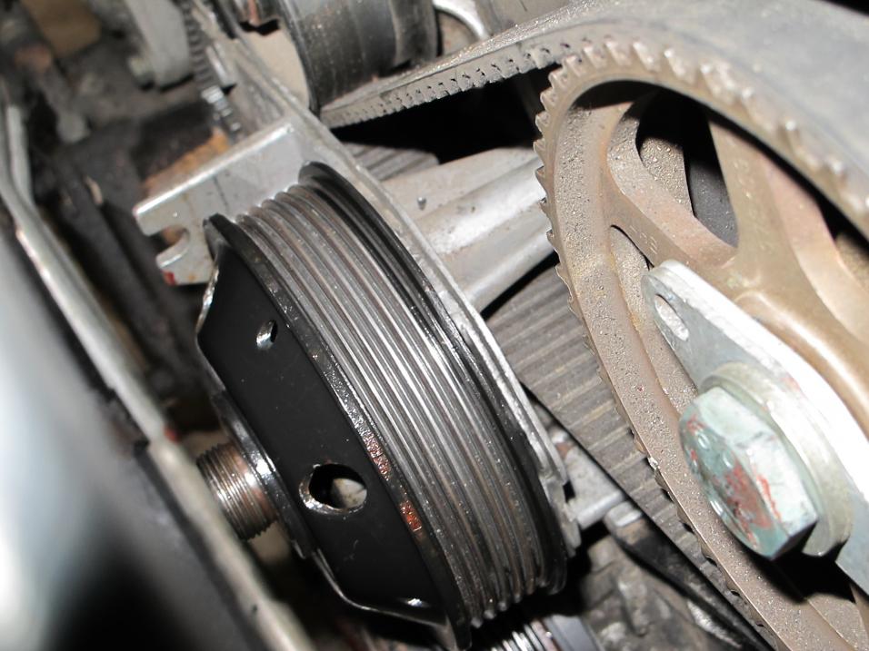

Well, I've been thrashing all day long on the new A4 as I slowly get to the timing belt to replace it. So far, so good but I've hit a snag in that the Fan/Fan Clutch Pulley is hung up and there's a couple of 8mm cap head bolts behind it that I believe are necessary to remove befor I can completely remove the cast bracket it rides in/on. I'm reluctant to try too hard to remove it by prying, fearing I'll break the casting so I've got it soaking with Liquid Wrench right now in hopes that I can somehow break it loose. Any suggestions/ideas would be most welcome. Don't remember this as an issue with my A6. . . Here's a couple of pics to hopefully help:

IIRC
I think if you spin the pulley you can get the holes to line up with bolts behind it. remove the bolts through the holes and it falls right off

I'll try this but the first time I did, I could only see one bolt through the hole, via an inspection mirror, but not the other one. You're reply has given me renewed courage, so I'll give it a go! Thanks again and stand by. . .

Just wanted to let you know that I was able to successfully remove those two concealed cap bolts!!! Two different sizes, which are hard to see with such tight quarters and using only an inspection mirror and flashlight! The only thing that suffered in the process was time and my barked knuckles, also due to the tight quarters!!! Thanks for the tip and I'll now hav the belt changed in less than an hour- just have to lock down the crankshaft and then remove the old belt. . .

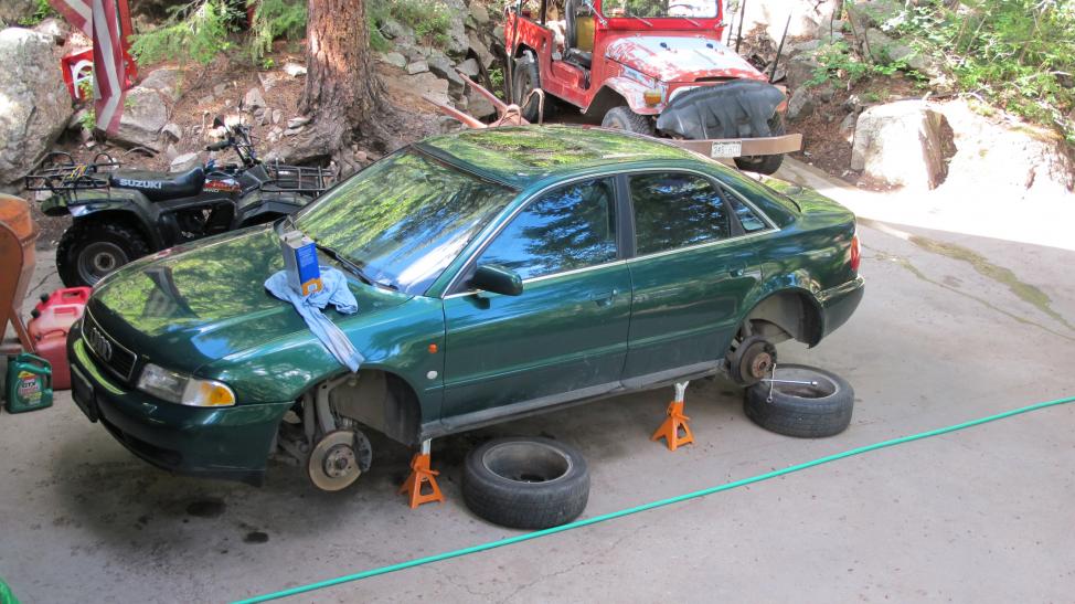

Default New Timing Belt
Hey Jim et al!
Nope, didn't know about removing the bumper but got the job done anyhow despite my ignorance. Peace of mind is now mine! The existing belt actually didn't look at all bad but the previous owners had no knowledge of when it was changed and with what the job typically costs, one would think they'd remember! So, new belt. Here's a couple of pics of the car, wheels off for cleaning and general inspection. . .
