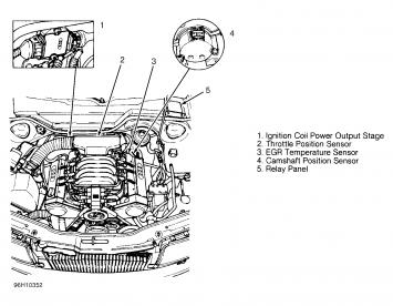

That is the EGR temperature sensor which screws into the bottom of the intake manifold on the far side from the EGR valve and behind the throttle body. You will need a 14 mm deepwell socket for a 1/4" socket wrench, with a slit cut in the socket for the sensor wires. I used a 3" diameter abrasive cutoff tool to make the slot. You should put antiseize compond on the sensor threads. You should undo the wire ties so that the sensor lead is free and unpluged at the terminal, as this sensor is rather expensive. You will need to remove the throttle body to get the sensor back into it's hole. You should check that the EGR passage has no carbon in it from the EGR valve to the EGR sensor side and that the port at the bottom of the intake manifold is open.
Old Jan 26, 2010 | 07:55 PM
  #72
Midniteoyl's Avatar
Joined: Mar 2009
Posts: 3,042
From: Indiana
On th e'96 2.8 it's located on the Driver side...

THANK YOU both for your invaluable input and wisdom! I'll be sure to let you know how it goes. With the throttle body removed, can the EGR sensor be inserted and tightened with an open ended 14mm or does it set too far inboard? Just curious but certain can notch out a 14mm deep socket. . .

Got the sensor in place, removing the throttle body but leaving the throttle cable in tact. I now understand why I need to fabricate a tool to tighten it down! Rather than sacrificing a deep socket, I thought I'd cut down and trim a 14mm closed-ended wrench to fit. Think it'll be easier to cut and notch with my cut-off grinder. All's good and I should have new joy tomorrow. Thanks to you two again for your input! By the way, the sensor ended up located on the passenger side of the intake, just inboard of the throttle body mounting and installs horizontally with the terminal end facing inward. Disconnecting the sensor, I was able to lightly clean it up on the buffing wheel, removing the carbon buildp-up on it.
Good to know.. hate when the service manual is wrong
