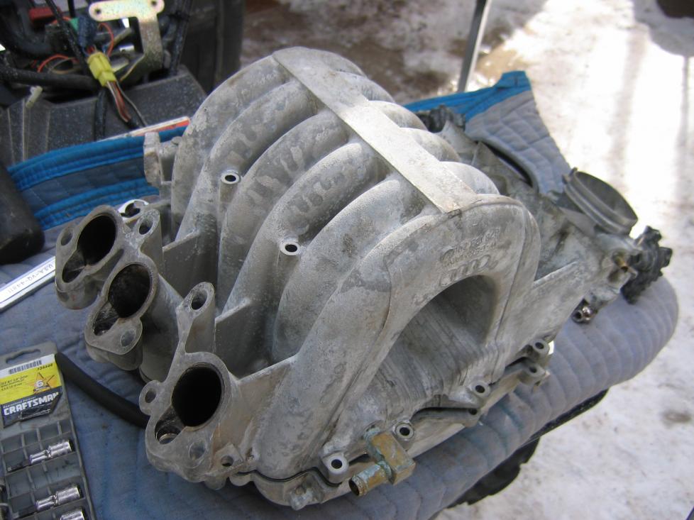

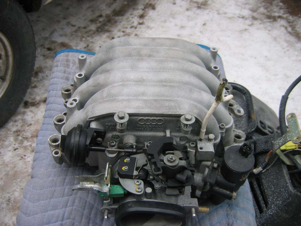

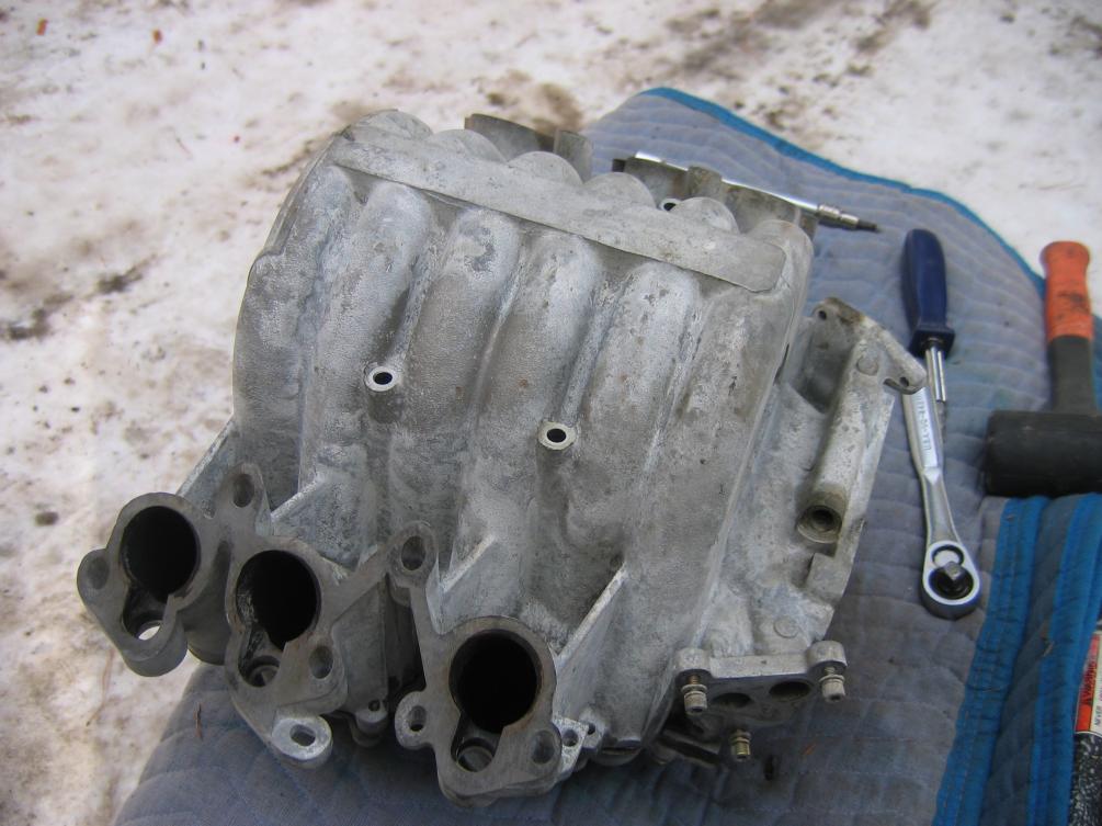

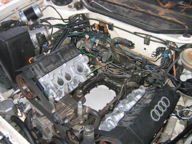

Default Good day at the office!
A few pics for your viewing pleasure. Sandblasted (lightly) the intake and throttle body and thoroughly washed all afterwards. It all cleaned up really nice with no damage. The engine compartment shot reveals the valley cover, which received the same treatment of sandblasting. Installed the valve covers then realized I forgot to insert the plastic baffles! It's all good now. Going to loosen those camshaft bolts and sprockets then dial in the timing and tighten it all down. So far, so good. . .Thanks to all for you input and help. Don't think I could be doing this without this forum. . .

Kewl.. Kinda shame you couldnt pull it all and give it a good bath... maybe in the Summer

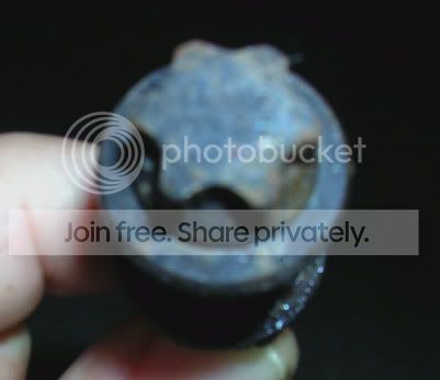

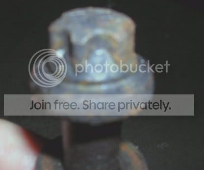

Originally Posted by chefro
Obviously you have the triple square kind, as ryuuoh already guessed it.
I had a star-headed type of bolt.
If I would guess, probably 10M is the right size for your bolts (it looks fairly small), but don't take my word for it.
Unless my eyeballs are fooling me that picture looks like a double triangle not a star - But we don't have stars in NH so I don't know what they look like.
Old Jan 21, 2010 | 04:08 PM
  #56
chefro's Avatar
Joined: Dec 2008
Posts: 1,941
From: IL
I don't know what to tell you, Fred.
The socket I used (E12) came from a 4-pc Great Neck set bought from AutoZone.
It was called "Interior Star Socket", so if I called the bolt "star-headed" on a wrongfully assumption basis, I apologize for the mistake.
