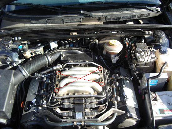

Regarding the engine top cover, do you recall if the rear (closest to the throttle body) attachments (2/4 Dzus Fasteners) is attached to the fuel rail via some bracket extension? I see nothing but "air" under that top cover and those rear pair of Dzus fasteners leading me to think I've misplaced a mounting bracket when I tore down the top end and removed the fuel rail. . .Had the inspiration early this morning to comb through my parts tank in the hopes that for some reason that suspected missing bracket is floating 'round the bottom of that tank. . .

Now if I can just figure out how the back Dzus mountings work with the top cover. . .I am suspicious that the mounting bracketry, whatever it is, was left behind at a Denver Audi Dealership when the car was first towed following the breakdown on the road. They partially tore down the top end pieces and put them in the trunk when I declined the repair. I think maybe this one piece, whatever it is, got left behind. . .Anybody got a pic of the mounting method, I'd be grateful. . .Even got the security code for the radio installed!

There are four flat head screws which hold the fuel injector rails in place and the two brackets which have the four spring steel fasteners for the top engine cover. You should be able to find a picture at www.vagcat.com , under "engine, covering".
Thanks, Jim, for the pic which has proven to be immensely helpful. I now am very clear that those brackets are either around here someplace or that I somehow inadvertently threw them away. . .Hoping for the former. I'm sure I had them rather that getting left at the dealer and the fuel rail mounting screws are tapered heads to accommodate those mounting brackets. I'll find 'em somehow and somewhere.
