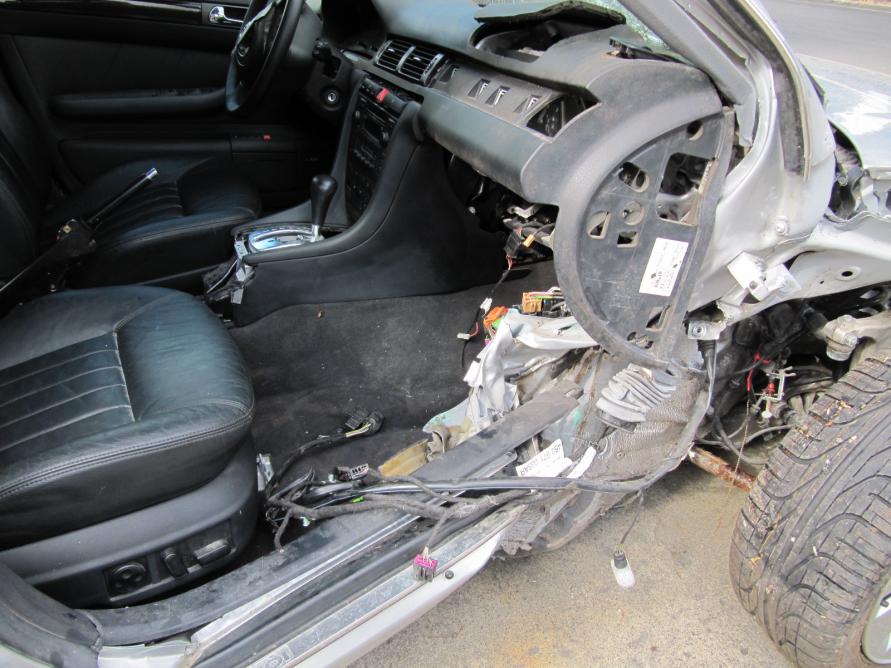

I think TCM is right under the front pax carpet and it was hit pretty bad at the same location... you know the rest of story.

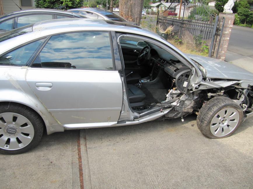

well yes, was hit pritty hard. i will attache a few pics. and yes, the car has 2800 miles on it. i don't really know the whole story of the car. What i know is that this guy bought it from a auction back in 2001. He bought it for himself, hi is a body man, but in the same time he is a gambler too. So after 11 years kept in the garage, he got in some trouble, money, debt, he decided to sell it. So i took it off his hand last year. I don't know more about the car.
But, when i'm trying to take off, it seems like is in 3rd or 4th gear. Doesen't have power. I still have to bleed the brakes, after that i'll to drive it around, see what's going to happen.
I'll get back, and THANK YOU !!!

Make sure no water made it's way into the ABS or Transmission control modules. They are both located in that location. If this car is outside now make sure to keep the weather out.

angelyno55, by the looks of it, check the TCU Module for any damage. Check the connectors the pins and even the wiring(check for any exposed wiring that would set it off).
Clean the TCU and connectors.
