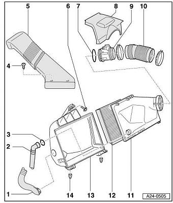

Hello to all,
Where is Air Filter located in the vehicle? I m using Audi 6.
Old May 17, 2009 | 04:45 PM
s31523's Avatar
Posts: 105
Left hand side. Look for the big round pipe connecting to a large rectangular cube. There are 3-4 silver latches the pop off. Use a screw driver, they are on tight. The rear-right one (when facing the vehicle) is a real bitch to get back on. Changing the air filter, like just about everything, is a pain.
