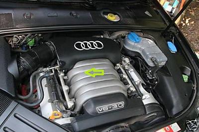

I bought an automotive stethoscope today at advanced to pinpoint the sound. I attached a picture below with a green arrow pointing at the spot where the noise is coming from. The guys at advanced told me it sounds like a stuck lifter.
The car runs fine and does not have any check engine lights on. There is no loss of power or anything else but the noise.

I took my car to the dealer today to inspect the noise. They told me that the lifter is the problem but they need to remove the valve cover to inspect and give me a definite answer on the problem. Along with that they would have to replace the timing belt. A grand total of about $2800. Is it necessary to replace the timing belt? Also, does anyone have a diagram or any steps on removing the valve cover to inspect the lifter?

It sounds like a collapsed lifter.

If you can narrow it down to the last cylinder (3) with your stethoscope than just order all the lifters for that cylinder, exhaust and Intake, and 5 valve seals and a few valve spring keepers in case one gets dropped in the process.
