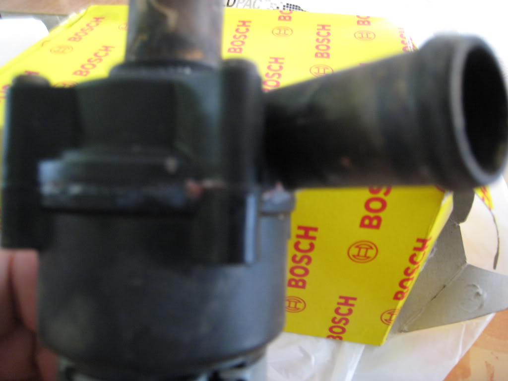

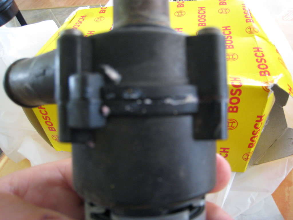

my coolant warning came on twice this month.. Expansion tank is not cracked so i figured it was the pump. I have seen a lot of posts lately on Audi forums from guys who have a leak, burnt smell, collant warning on... So i thought I would post this info..
Typically it is one of two things
1- cracked (look for yellow color spots) expansion tank, only 27 bucks at ECS Tuning and DIY
2- Dreaded Aux water pump: part is pricier at $110 at ECSTuning, could not find cheaper. Well did find one at 107 but I trust ECSTuning.
labor is IMO 2 hours, I know some of you out there will come and say I am a moron and can do it in less.... But plan on 2 hours is just my opinion. Oh and mineis a tip
You have to remove the intake, as it is under it. In the process, since the intake is off, put in some NewSouth Power gaskets for 75 bucks and no extra labor..
The stock pump is in part made of plastic. The area where the two plastic parts meet (screwed together) leaks easily and caused the problem you witness, also the plastic part is only clipped to the metal section, and could also cause leakage.
Pics below show my old pump which was just replaced yesterday, i also threw in the powergaskets to reduce temperature. We'll see how they go...
The last pic just show the box the new pump came in so you have the part info. Anyway, on the middle 2 pics, you can see some of the junk where the leak occured...
