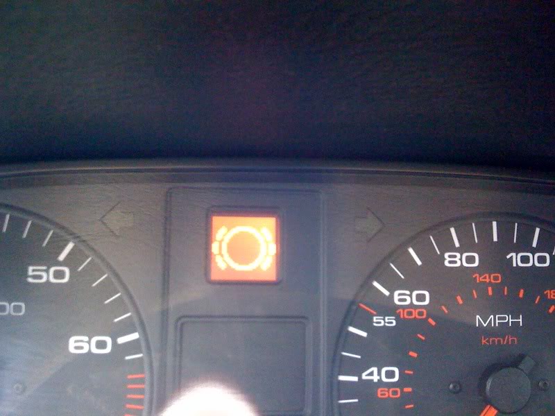

Im trying to figure out this break issue as quickly as I can, as soon as the car is started I get the warning light :Name:  photo-1.jpg
Then it will alternate between that light and the "Brake Light" warning. I noticed that as soon as it says "Brake Light" the car will hesitate to accelerate and when you take your foot off the gas the car will start to slow down as if the brakes are being pressed. Sometimes at slower speeds you can actually feel the car jerk forward and the speed drops a couple miles within a second or so. Any ideas where to start or what to check out? The car is a 95 A6 with ABS. I am not sure which ABS module the car has or how to find out.

that indicator on your front dash means your brake pads are worn down, there are sensors in the brake pads that if they get worn down enough it causes that light. The fluttering of the speed may be caused by a faulty abs module, they are pretty notorious to go bad in audi's, mine just went bad and had to get it rebuilt, they are very expensive if you buy a new one. I'd hook up a VAG code reader and see what faults are being spit out and start from there.

Ok, so last night while looking for random stuff in alldata I stumbled across the warning lights. I found out the "brake lights" warning was because a bulb was burnt out. Do'H! Anyway the rear brake pads do not have a sensor only an ABS sensor. I though the preivous owner might have been super cheap and bought sensorless pads but could not find a connector on the car for a sensor wire.

The sensor is a wire that is embeded in the pad - when it wears to a certain piont the wire is cut and the light comes on.

If you save the old brake pad sensor wires with the terminal connector with the two pins, you may use it to fix your problem. Just solder the two wires together, then plug it in to the terminal socket which is on the end of the cable going through the wheelwell wall.
