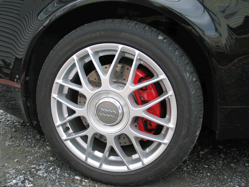

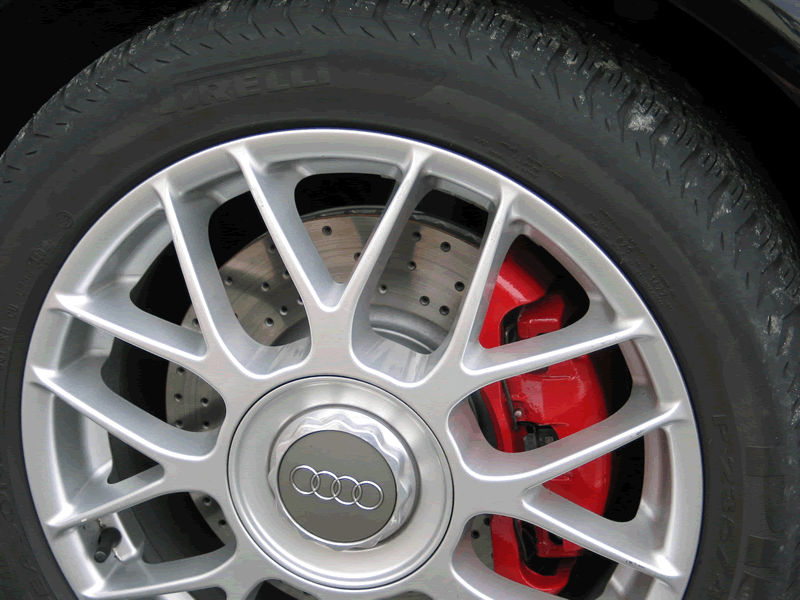

i did my brakes about a month ago ... Last night I was touching up some caliper paint and i took everything apart ... i cant get the damn clip for the front calipers back in for the life of me ... see i did one at a time when i changed rotors and pads but i took everything off so i have nothing to compare how the clip sits on the caliper to ... please give advice or tips to get these buggers back on easily
02 2.7t 1 pad application**

ORIGINAL: joetm ... please give advice or tips to get these buggers back on easily
Yeah they are a b!tch to get in sometimes...
I "rolled" the middle in first and then pryed the top and bottom in one at a time...Then I "pulled" the spring over the chrome pins... Actuallyit was only one at that stage ....if that makes any sense...
Not sure if these will help..
http://www.vaglinks.com/Pics/20061217_Audi_0921.gif
http://www.vaglinks.com/Pics/20061217_Audi_0922.gif
