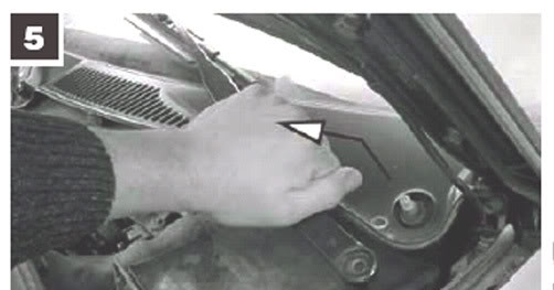

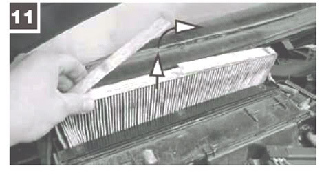

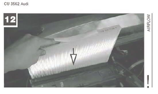

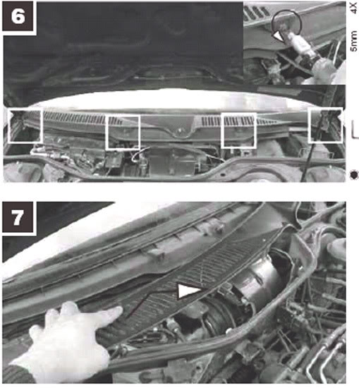

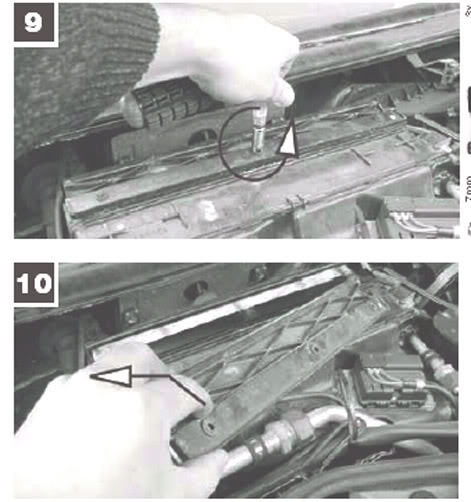

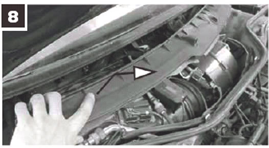

So I started googling for a little bit:
1) Look on page 55, for the "Audi A6 (C4) from 1995-1997"
2) Also another source:
3) And yet another source in pdf form which I altered in P-shop:
Even though after looking at these pics it looks like my steps where a little off, at this point I would say that it is safe to put a filter in.
Don' t you?
