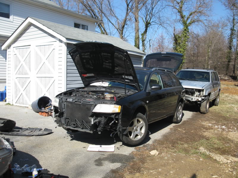

she is jacked up so high looks like an allroad

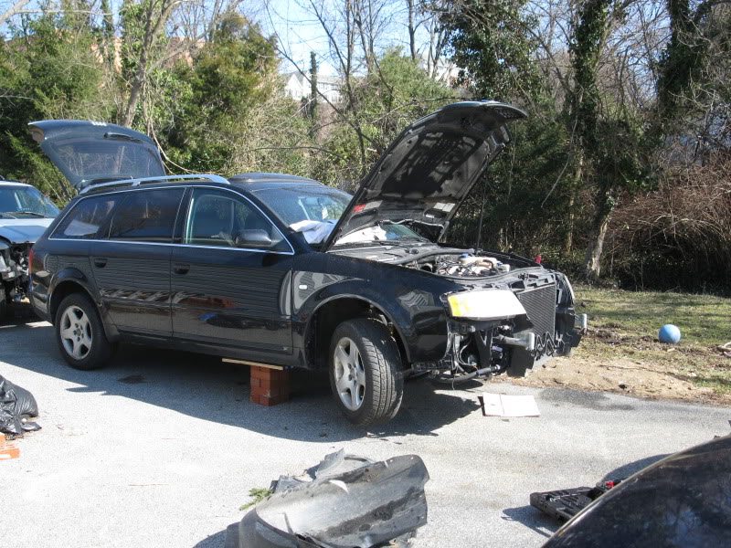

couldnt wait another day for my friend to get jack stands so gamble it is

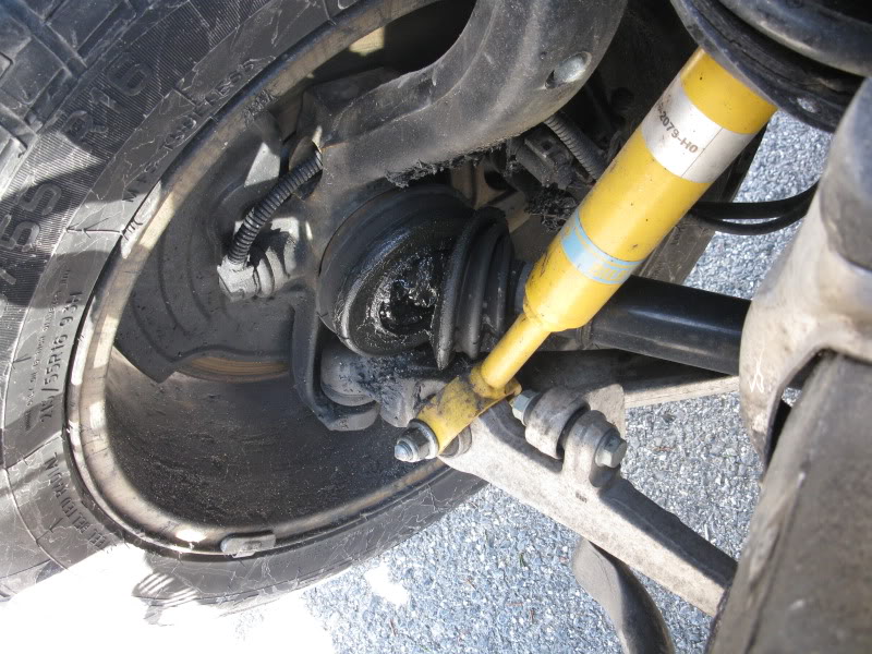

my cv boot is crying for attention

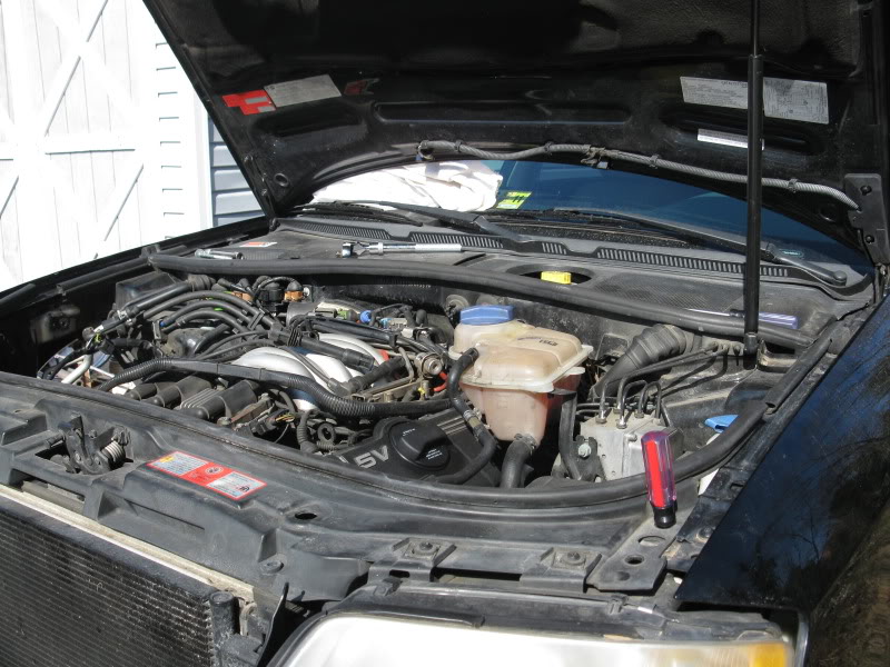

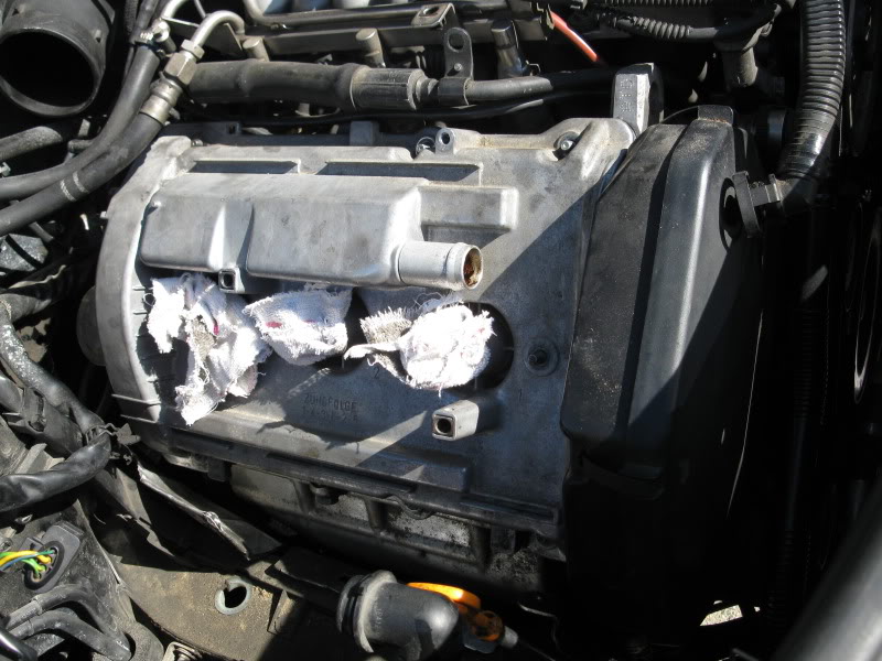

dont know if i should of done this but i was scared of things getting in there is it safe to leave this towels in there till i finish taking the tb apart?

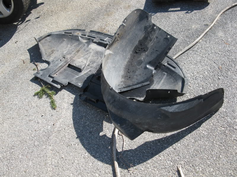

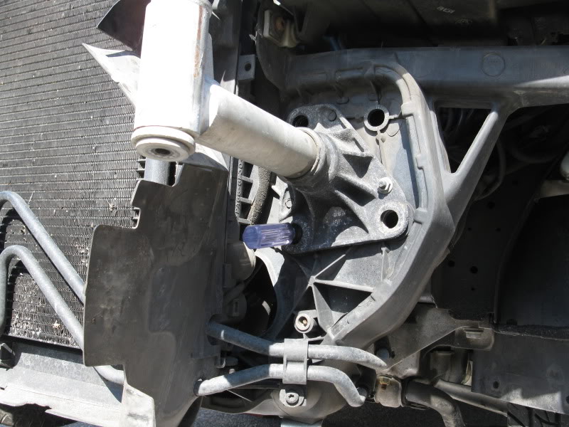

turns out its impossible to get the 3 bolts on the inside of the bumper on the passenger side without taking the wheelhousing liner out

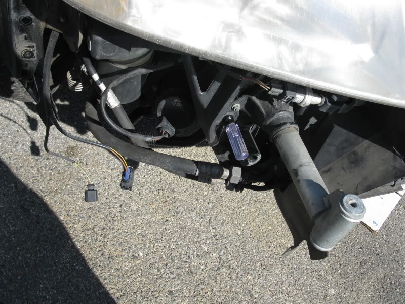

i used long screwdrivers to hold the lock carrier in place until tommorow
