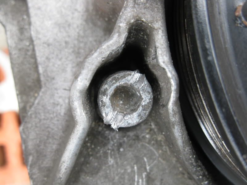

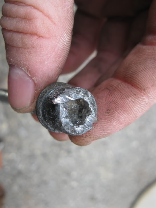

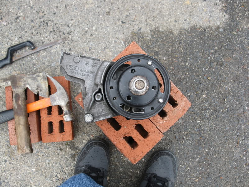

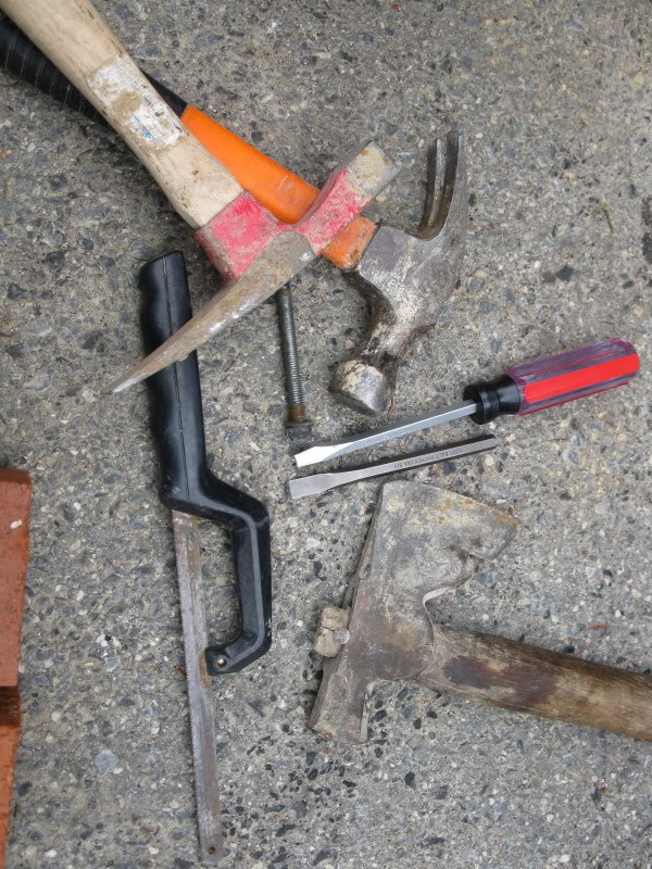

so while waiting for those tools i cant really do much but i did manage to get that sucker out (the fan assembly bracket)...
after about an hour with this guys:
it came out(gotta get a new one guess its a trip to th stealership lol) :

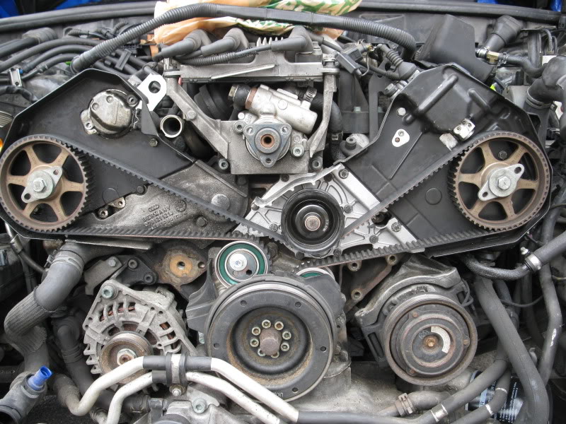

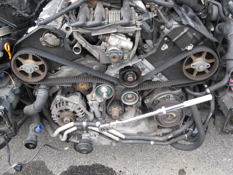

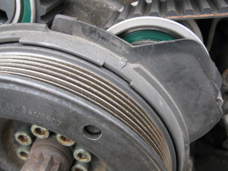

then this sucker tricked me because after u turn it to tdc(is tdc when the mark lines up with the line on it?) and try to get the 8 bolts out it keeps on turning
then i got some wisdom lol held the 12 point with a 24mm socket and broke all 8 bolts loose turned it till it lined up and then took them out

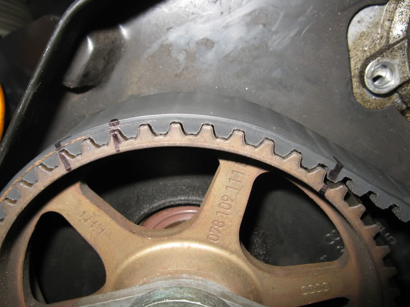

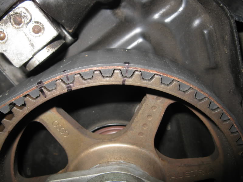

the i made a buch of markings, better safe then sorry right (should of gotten a different color...)
stuck an allen wrench in there works fine

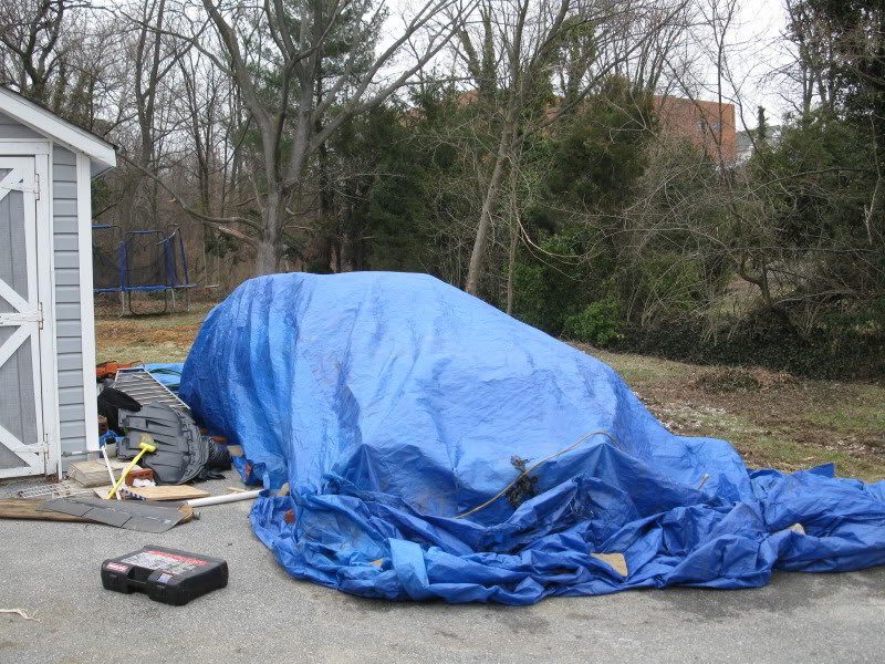

i know this is unrelated to anything but check her out wearing her rain coat... lol
they said it was going to rain all day and all night but no rain yet

You don't need the alignment tool just keep repeating a cross
cross pattern on the cam cap bolts. Its a long tedious process since the bolts are so long. As soon a a bolt gets resistance move to the next. You'll circle around 3-4 times before the caps seat to the head and the lobes push the valves down.
As far as the position, look at the cam shafts, there's a small square notch at each one. Assuming your crank is still set to TDC, those marks will align with the arrows on the rear of the head, just forward of the tensioner. There should be 16 chainlinks between each cylinder head reference mark. Your manual should explain this better than I.
Good luck and thanks for the write up and progress pics. Good references.

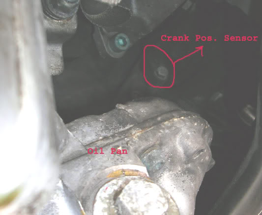

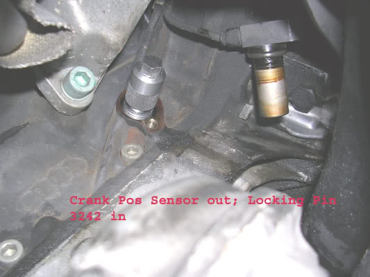

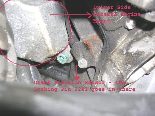

i also forgot to mention this: i couldnt find where to stick the damn crank locking pin 3242, the illustration on bentley was useless. and then i forgot about it and went on and now i see it laying around lol. i hope im not screwed, and didnt damage anything.
mmmm where should i stick it?? and does it even matter at this point?
