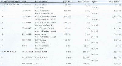

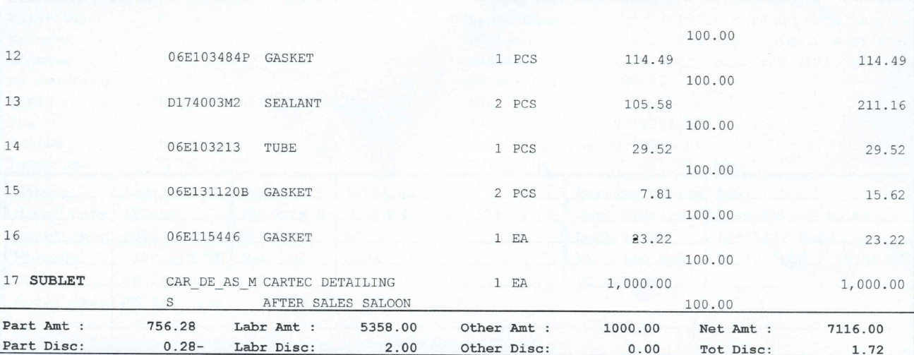

They promised me a major discount on that job, and as they promised the bill for that job was dropped down to 7116 from 12520 (this is in local currency btw: 3.67 per 1 USD). So I paid and took the car back home and only then I had the chance to compare the two cost estimates. It seems that in the new job :
. Now if you look closely and compare, there are major labour cost reduction due to the fact that they decided not to dismantle the engine and the gearbox, but what's also more interesting is that they decided to replace only 2 sealants instead of 3, and replace 4 gaskets instead of 2. And they screwed me by charging me for car detailing that I didn't even request (on the phone they just said they will give me a complimentary detailing).
Now I don't trust these guys at all, mind you they are the only authorised Audi dealer in the city !
I am not expert in cars, but I am an engineer and I have a sense of what they might have done. I think they skipped the engine sealant replacement, thus reducing majority of the cost associated with it, and told me that they gave me a major discount for the same job. AND they made me pay for the detailing they said it's for free. I feel like an idiot now
Now, even though I want to do some of the other jobs, I am now worried that the same story will happen again. Can you guys help me identify what can be an urgent job to do next and how can I verify it without relying on the dealer?
