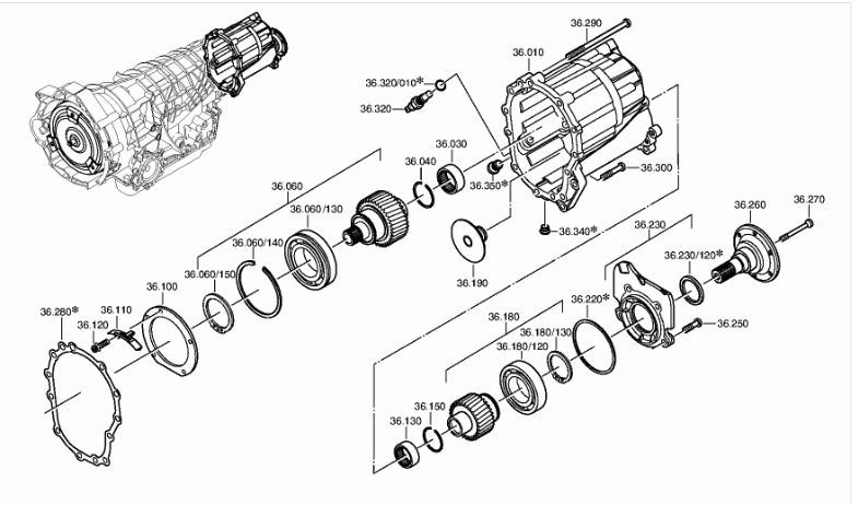

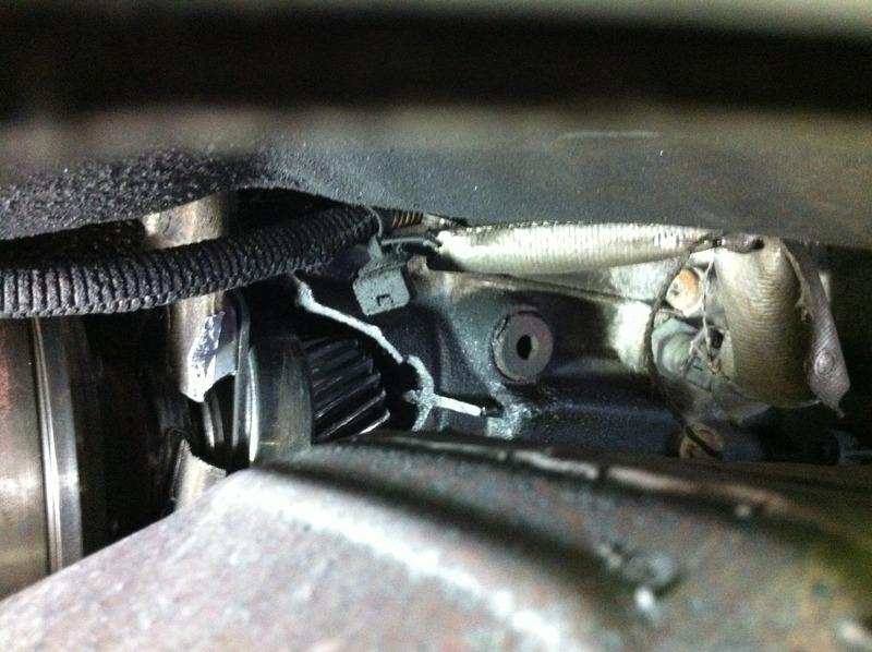

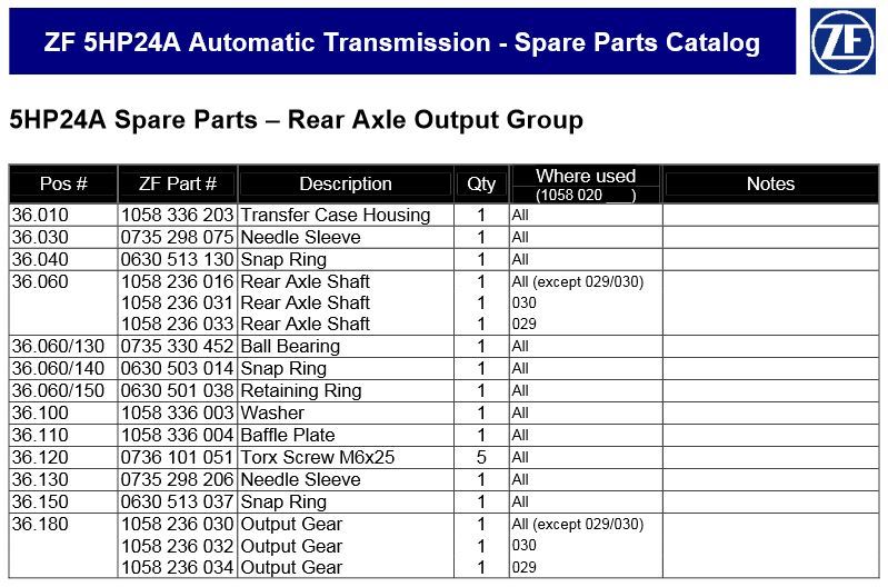

Bad day driving my newly purchased used AUDI. (Pics below) Only had it going on 3 months now and had catastrophic transmission failure. The rear output transfer case housing is all busted to pieces and being on a budget Im debating two options. One is to order parts and do the repair work myself, or buy a parts car and do a transmission swap. I know it's a few variants of transmission models in these cars and I'll need an ECF model. Parts cars are going cheap, like 700 to 1000. And a used transmission in salvage yards are going for about the same price as buying a whole parts car, so its kinda a no-brainer going that route. If I do consider buying parts, can the repair job be done without removing the transmission. Looking at it, it looks like if I drop the exhaust, I may have plenty of working room, but not certain. Im curious, has anyone had this happen to them, and what route did you take to repair it? Where can I find the rear output housing case and parts?
Here is a pdf on the transmission and parts view diagram http://www.zf.com/media/media/docume...a_4/5HP24A.pdf
The housing is on page 21 part number 1058 336 203
