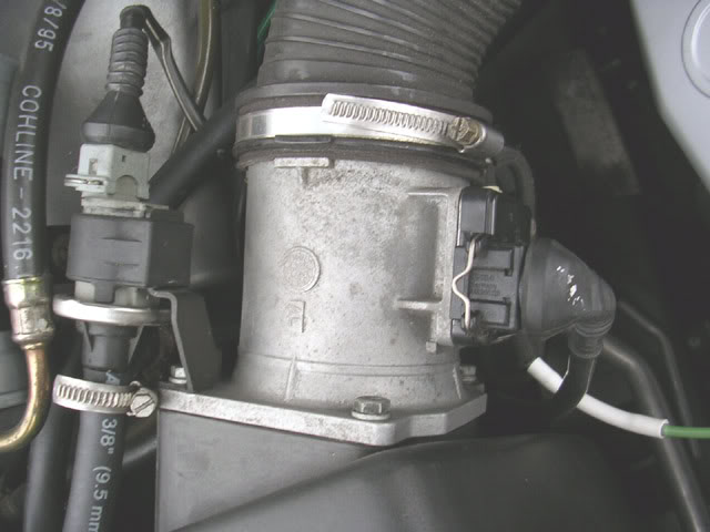

Old Nov 17, 2009 | 01:05 PM
chefro's Avatar
Joined: Dec 2008
Posts: 1,941
From: IL
You disconnect it, pull it out from the air hose(s) - 2 clamps,...
I stand corrected (sorry):
The MAF Unit is fastened to the Air Filter box via 4 bolts (10 metric).
So you'll have to remove 1 clamp and 4 bolts.

MAF on a 2.7T is held by 2 vandal proof torx screws. You need a torx driver with a hole in the middle to remove the bolts. (If you don't care about the aesthetics, then a vicegrip is your best friend.)
But I would lean toward a vacuum leak for the cause of this problem.
