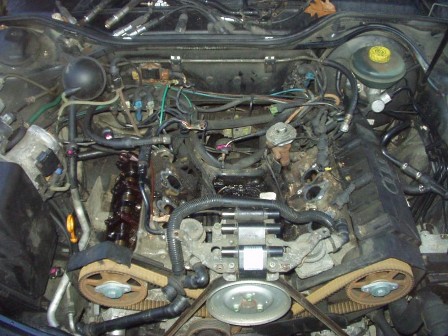

Default starting to tear it apart
ok so I took the intake off today. Nearly froze to death by thats the way it is here now. Anyway, I am going to have to go get a BIG torx socket to get the head off but I took a few pictures. As you can see the timing belt seems ok, not to say it is. I have had engines drop a valve or bend a valve before and it usually makes loud bad noises and this one didn't. And it still turns over good, just a little fast like no compression.
As you can see the crank is at tdc and the cams look to be where the big holes are supposed to be. I know it's not the cleanest but it did run!
