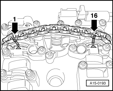

You can't really check the tensioner with the vag com. You can check the timing of the tensioners if you want to, but it can't move un-less you took it out. On the other hand if its bad it can cause this problem, but the engine will usually sound like a diesel if it is.
Here is a diagram of how the tensioners are timed.
