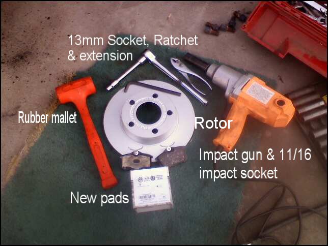

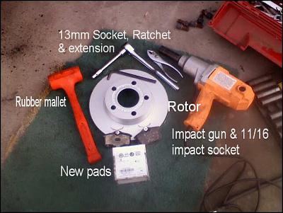

First things first, get all of the parts you will need. (See pic 1 & 2)
- New Rotors & Pads [OEM @ Dealership - Total $163 w/tax [REAR ONLY]
- Car jack with jack stands (Ramps will NOT work)
- Impact Gun with an 11/16 Impact Socket (to remove wheel)
- 13mm Socket with Ratchett and Ratchett extension
- 8mm Allen Wrench
- Rubber Mallot
- Clamp [Metal/wood clamp] (Forgot to take pic of! Sorry)
- One hour or so of your time

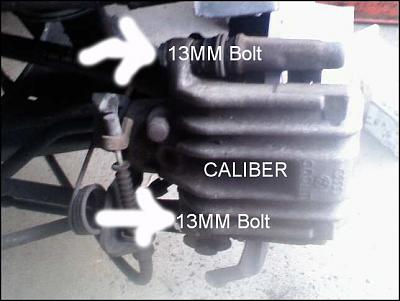

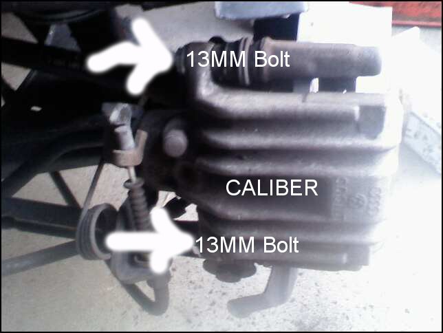

Start by removing the wheel using your impact gun so you can gain access to the caliper, old pads, and rotor. The first thing you need to do is remove two 13mm bolts holding your caliper onto the rotor. (Pic #3) There is one on top and one on the bottom towards the ground. For this, I found I had to use a wrench (not the 8mm Allen) to hold the inside bolt of the caliper still, while I loosened the 13mm bolt.
Once those two bolts are removed, your caliper is now "free/loose." However, it's still going to be sitting pretty tight. Use your rubber mallot with a little bit of force to knock the caliper off of the old pads/rotor, hitting it towards the rear-end of the car.

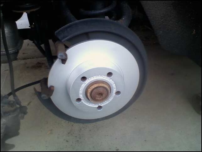

At this point, you are to the point of photo #4 (only with the old rotor). Now you may or may not have to remove the rotor bracket (Pic #4). On my driver side, I did. My passanger side I was able to just slip the old rotor out, wiggiling it around, and the new one in. If you have to remove this bracket: This is where your 8mm Allen Wrench comes into play. Looking closely at the back of this bracket you will see two allen bolts holding it onto the rotor. Place your 8mm allen wrench in the bolt, and using your rubber mallot, hit the allen wrench a few times until it becomes loose enough for you to loosen by yourself (they are TIGHT). Once the bracket is removed, remove the rotor (if your rotors are extremely rusty, again, you may have to give the rotor a few taps from behind to knock it loose (with the mallot of course).
Almost there! Now time for re-assembly!

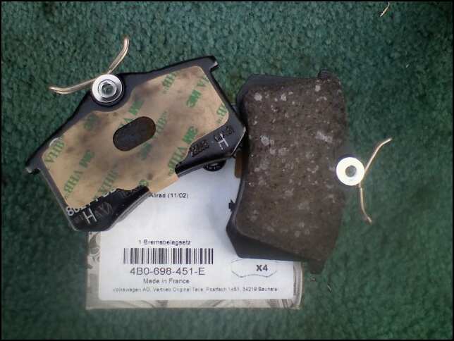

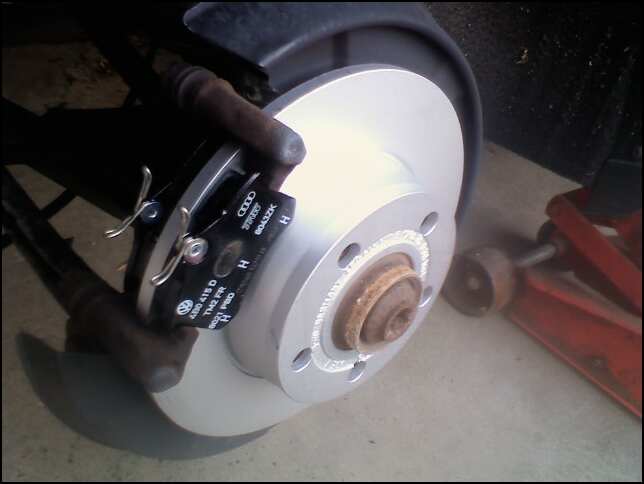

Place your new rotor on to the wheel assembly, lining up bolt holes. [If removed] replace your rotor bracket and re-tighten the allen wrench bolts. Place your new pads on the rotor bracket as show in Pic #5.
