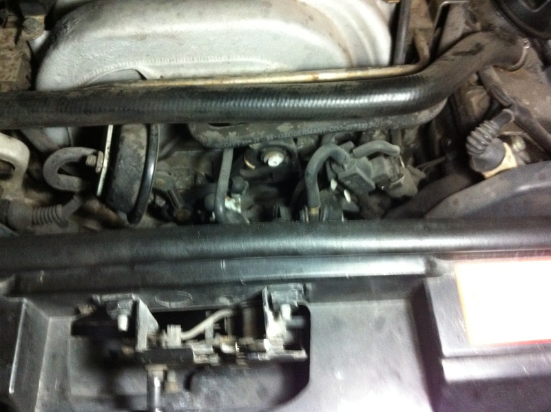

I bought a used 2000 A6 Quattro with the 4.2L ART Engine. The previous owners had really neglected this car for the entire 2 years that they owned it. Ive noticed busted linkages to the intake pivots, the vacuum actuators seem ok. Im curious if I can just find the linkages or will I need to buy the actuators all together as a set. They probably had been broke for some time, I cant get the leavers to budge any at all. Tonight I had sprayed wd40 towards the outer race pivot casing in hopes that it soaks in enough to making it slightly easier to tap out, We'll see... I found this nice write up online and thought I's share the tutorial. quattroworld.com Forums: 40V Intake manifold fix for stuck or sluggish flap pivots ( w/no broken parts )...
So yeah, This is what I'll be doing next. The two pics below are of my car. (please excuse the dirty dusty engine. When I get all the issues worked out she's going to shine like a new penny. =D Here is the link to the tutorial. This really is a great write up. I'd appreciate any other input someone may have doing this job.

When I still had the a6 4.2 I replaced those arms you are talking about with these:
Audi/VW 4.2 V8 Intake Manifold Linkage Arms - Gruven Parts
Worked like a charm and they won't ever break again (just the stuff around it). That write-up you posted is a great DIY post that I used as well to clean everything, since mine were also stuck
Geez, these will never break! Thanks a million Sheldon =D
