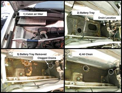

Originally Posted by CRuby
Here's some pics with the fender-fender cover removed. Cabin air filter sitting right there on passenger side. Thanks guys for the no-cover info. While I was there, pulled out the battery & battery tray & cleaned out the drains. One was completely clogged & the other was on it's way. Now onto the sunroof drains.
I read a service bulletin or something from Audi a couple of days ago, about the drains under that cover, there should be like a piece of rubber around the drain, grommet, they say to take it out because it can get clogged and cause the brake booster/battery to flood in heavy rain.. So it wouldn't be a bad idea to get rid of it in case of a freak storm...

It sure does clog. Floods that compartment (including the non-waterproof main computer) and then the cabin air filter, and then runs into the HVAC system and into the cabin. What a deeply stupid place to put a small drain.

Tried to increase size of my prior picture showing filter location & the 2 drain locations. I've read that some people have had both drains blocked & water sloshing around & getting into electronics below passenger carpet region.
